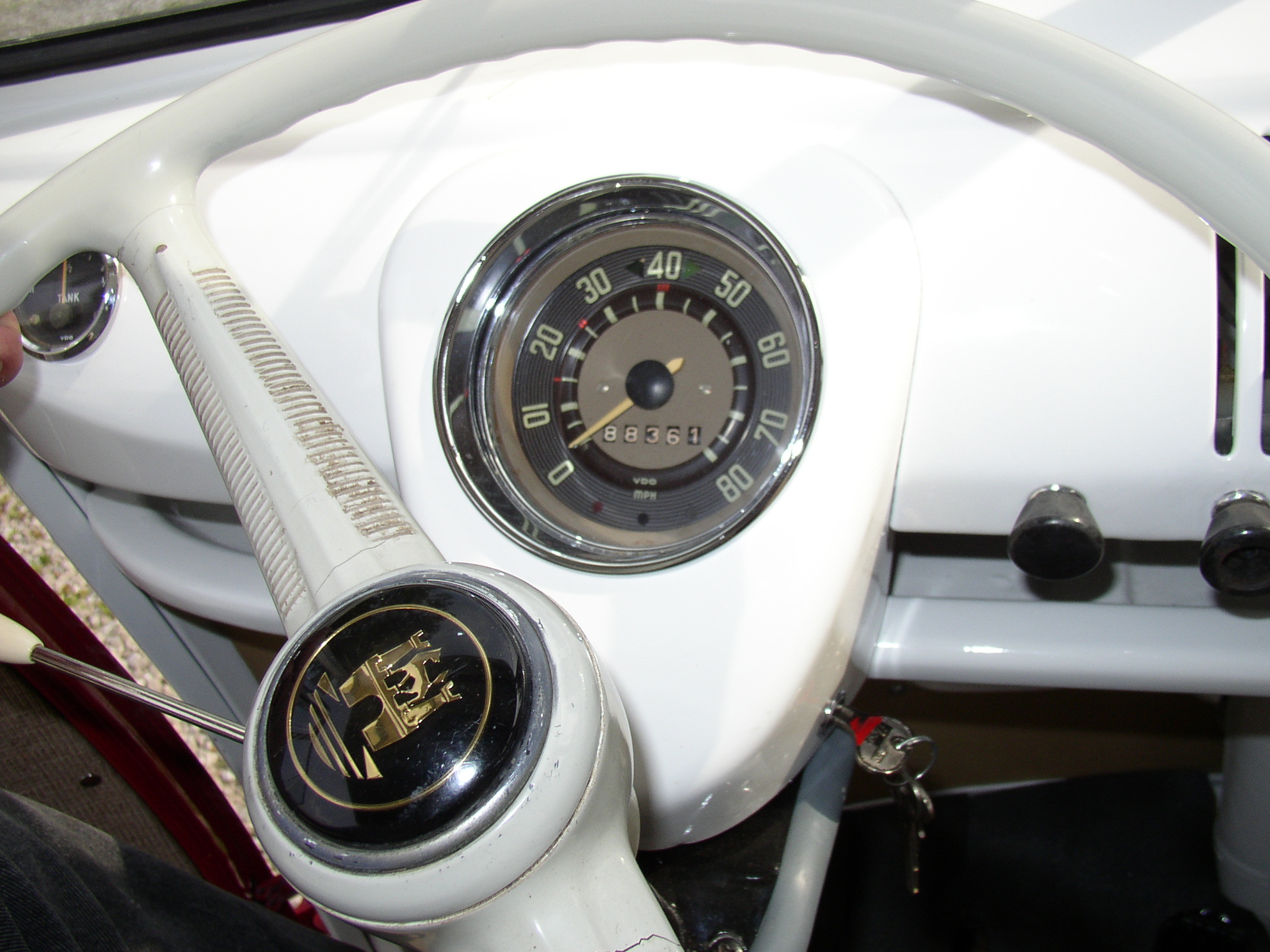

I bought a good used fuel gauge off of Samba, buffed it, and installed it. Gas guage works!

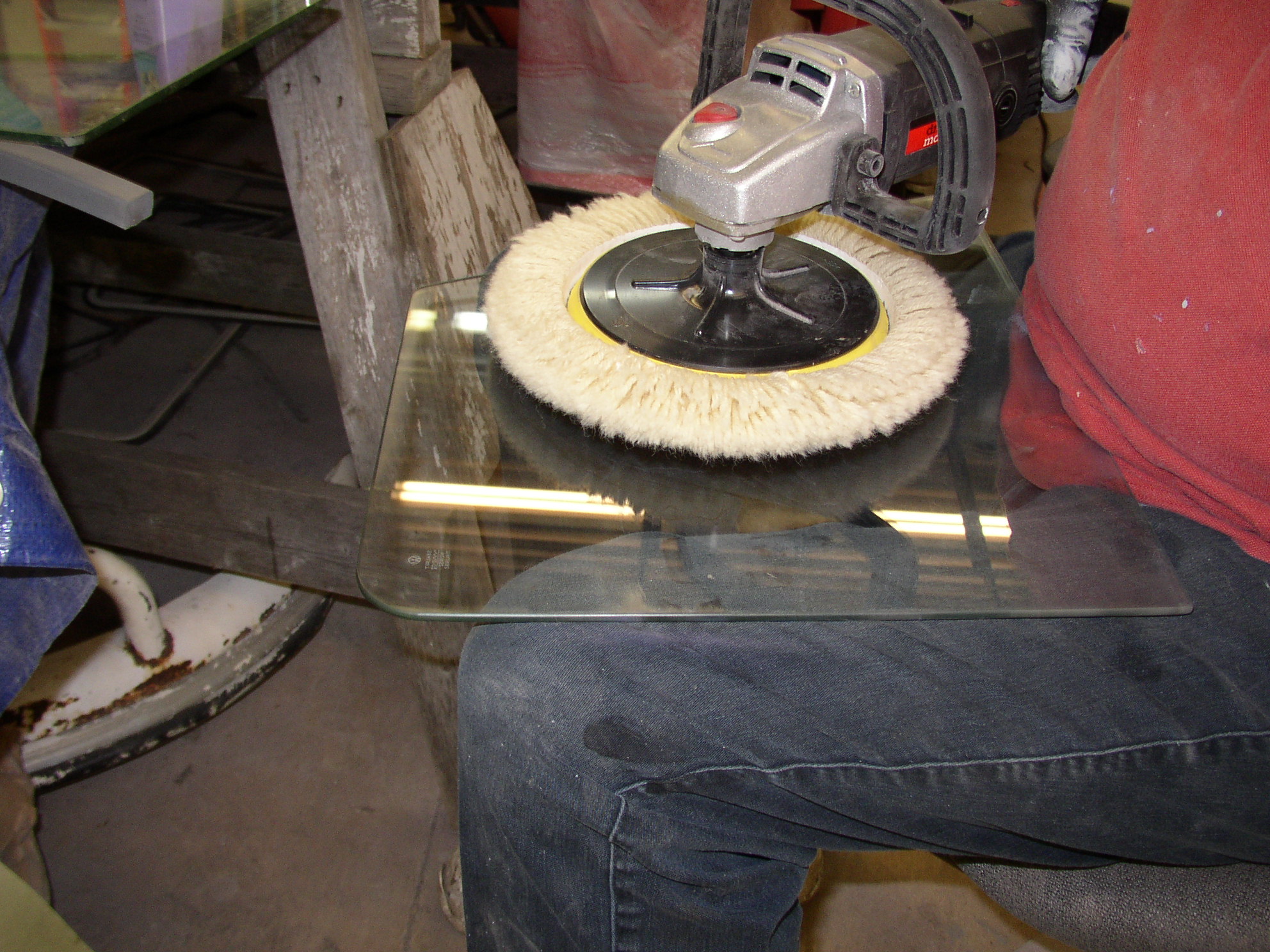

Getting ready to assemble, it's pretty straight forward. I just don't like doing it. I cleaned the glass per Lurch's advice with (???) glass cleaner (no ammonia) and 0000 steel wool. I then ran the buffer over them (the big one that I buff the paint with) with some fine compound, you can feel a big difference between buffed and unbuffed glass with your fingers.

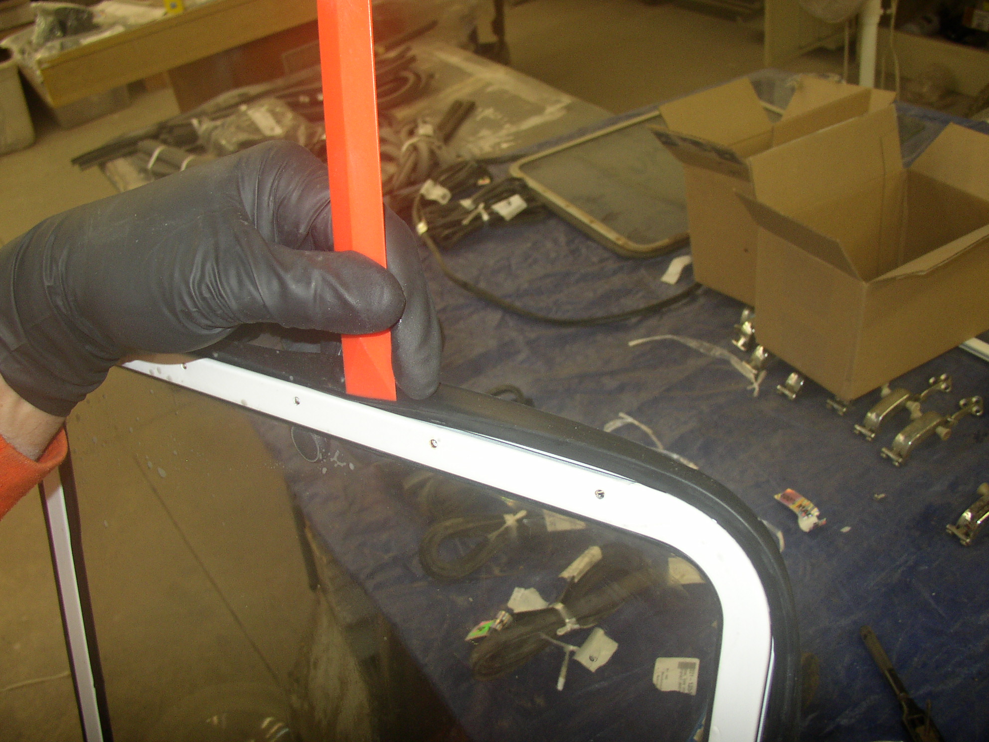

Putting in the outer seal in the frame was easy, but a plastic gasket scraper made it easier. The screw holes visible just under the scraper are the ones that were just a bit sloppier than OEG. Once again, Windex was my only lube. (as Lurch cringes....) From here it's just a matter of pushing the assy into the bus and screwing in the screws. A little kid could do it.

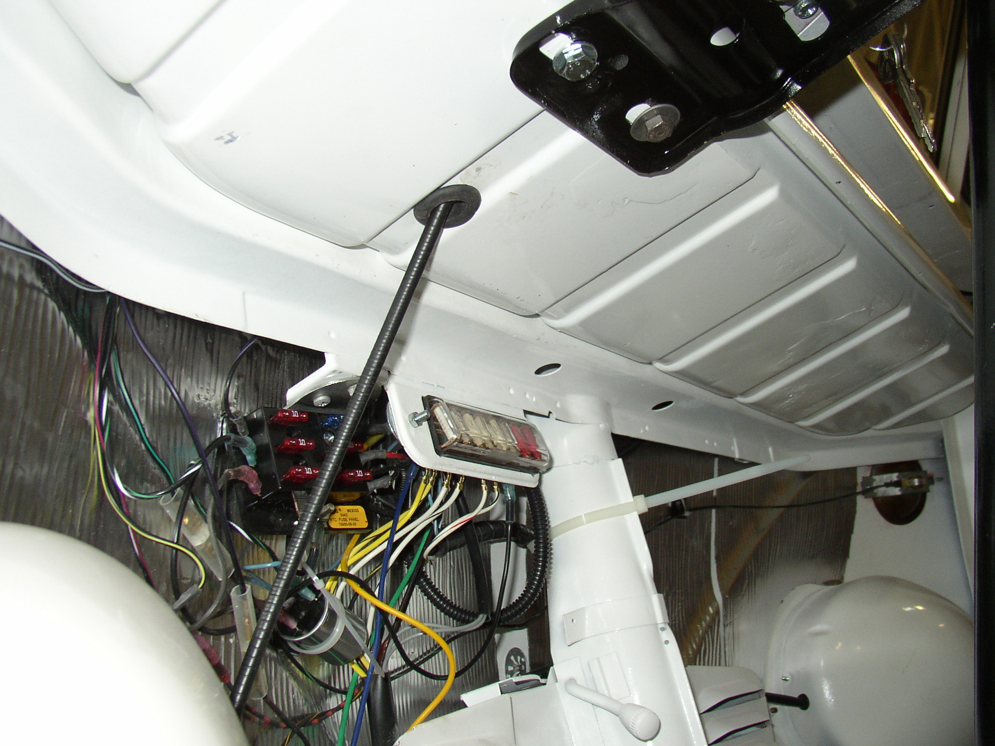

I finished the dash wiring and did what I could to clean up how it looks, but you just can't make these look pretty using a factory harness.
I cut a hole in the kick panel for the second fusebox and mounted the kick panels. I also cut the hole bigger for the speedo cable and put a grommet in, this allows me to remove the dash tray without completely removing the speedo cable. Obviously, I also installed the speedo cable so now the speedo works fine.

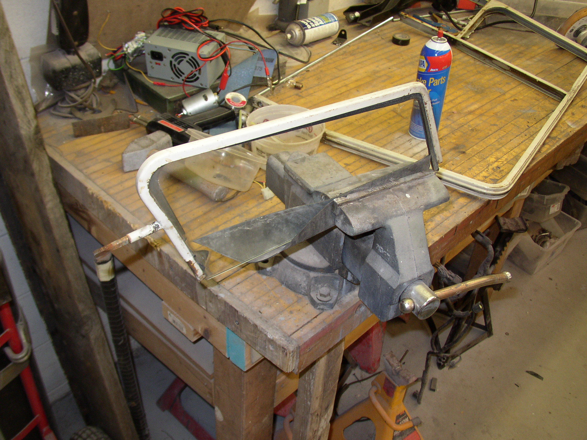

On to the RF window frame. Disassembly was rather easy but I did have to torch some of the small screws.

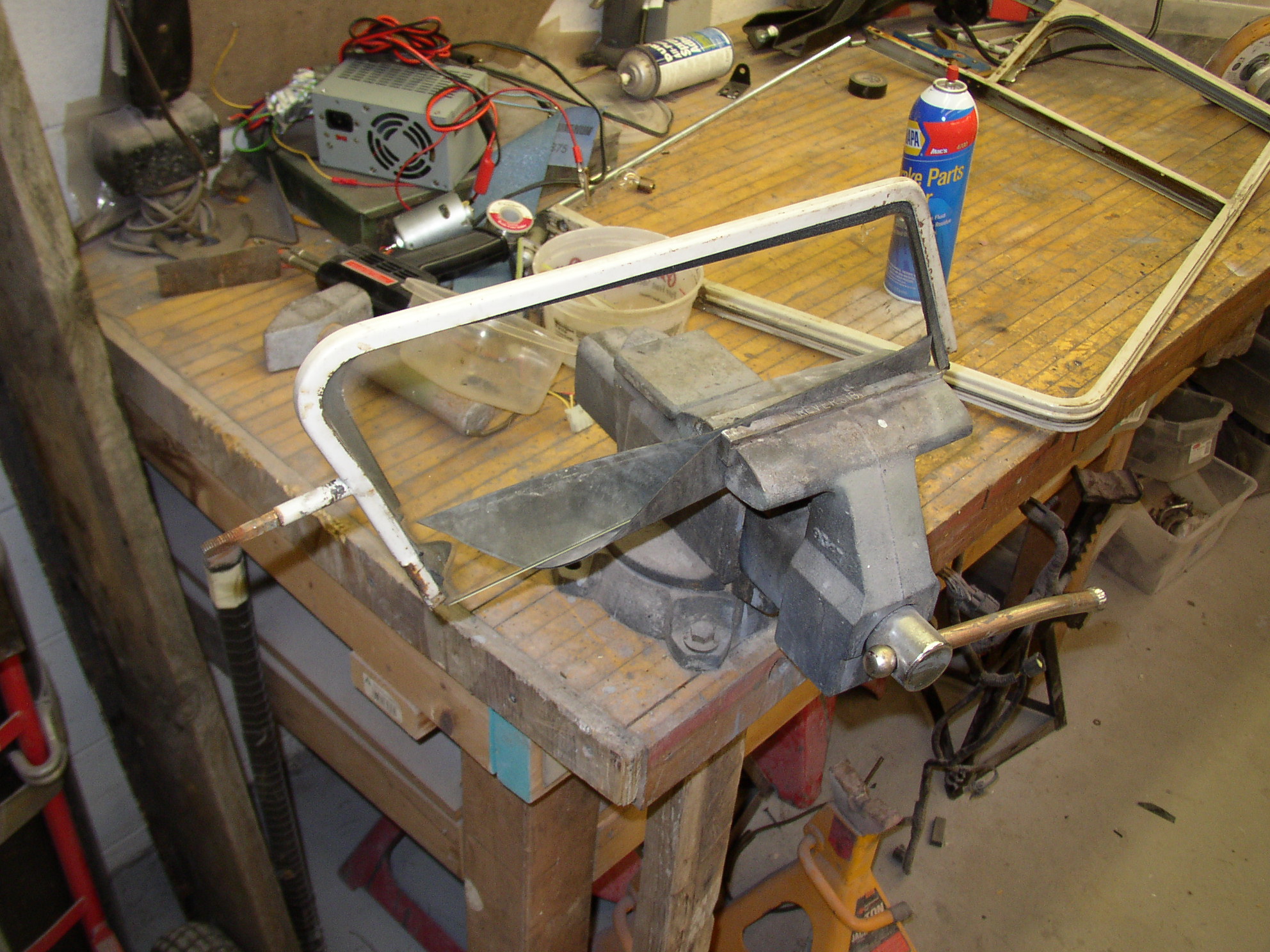

Put the vent window in a vise with rubber and pry the frame off of it.
Clean and paint all of the stupid little parts. Frames are a pain to paint because of all of the sides and edges.
Here it is partially assembled.
This "13 window" bus actually has 17 pieces of glass to clean 50 years of grime from, and it don't come off easy. First, a razor blade and window cleaner
Then 0000 steel wool.
And I ran the buffer over the glass with fine compound to give it a nice shine. I have hours and hours cleaning all of the panes (pains).

The vent glass went right in with silicone- only light pressure needed. On Ed's and Lurch's advice I used an extra popout glass seal.

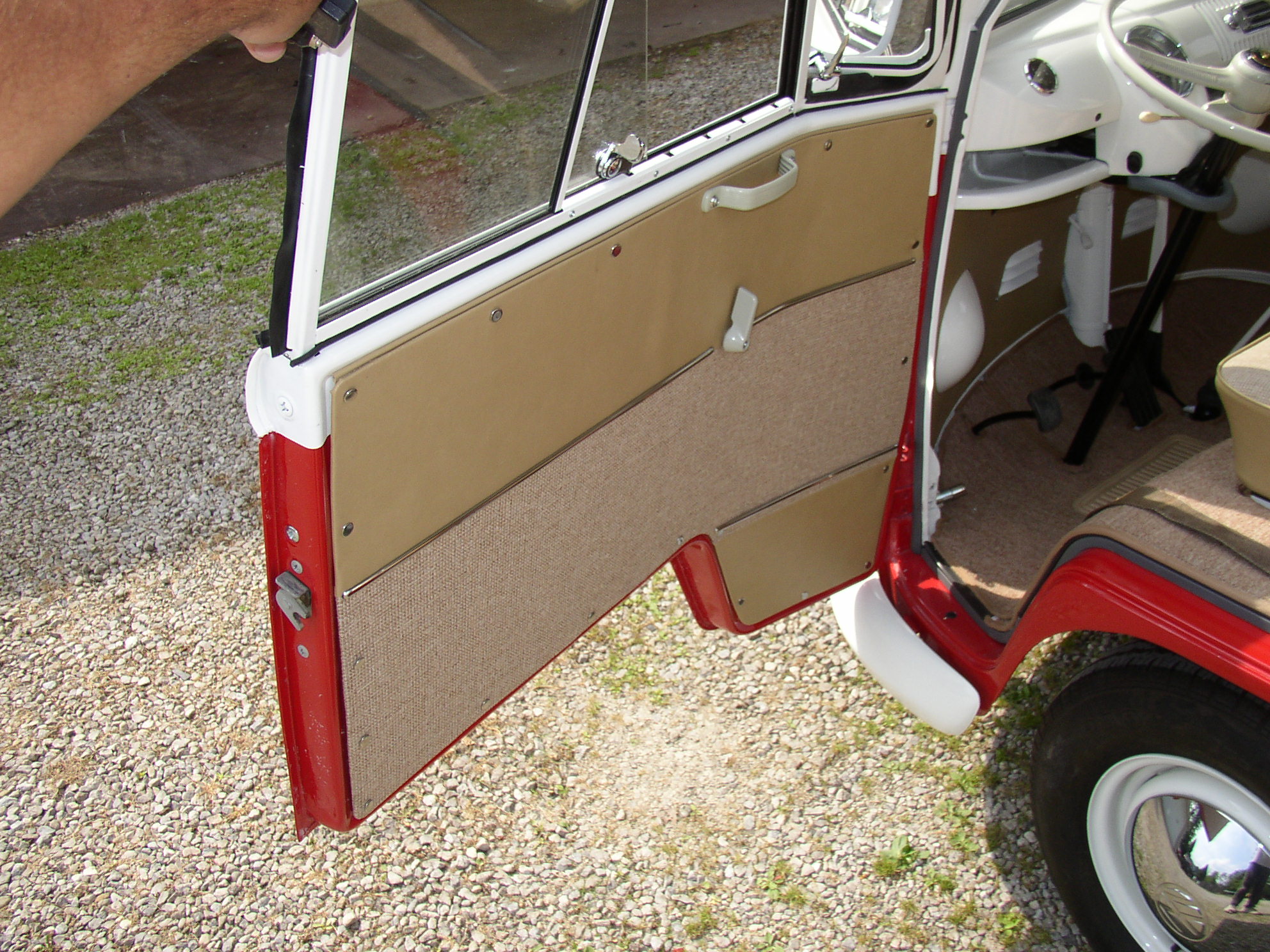

Here's the RF door done, panel installed, etc. I can't believe how many hours I have in this stupid thing, I hope the LR door frame goes faster. Installing the vent rubber and door panel is a real PITFA. I don't know how body/glass/interior guys do this shit all day long.

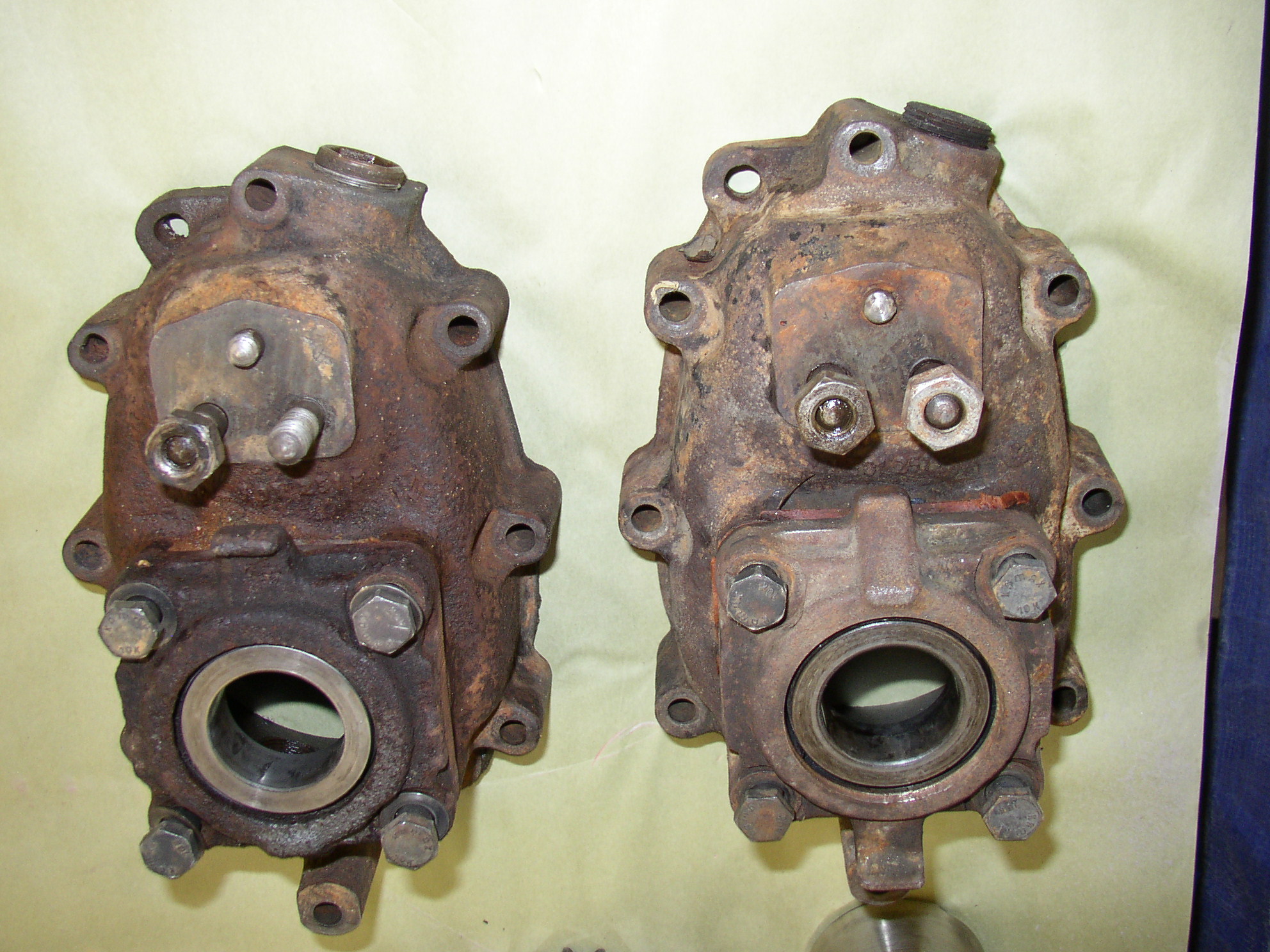

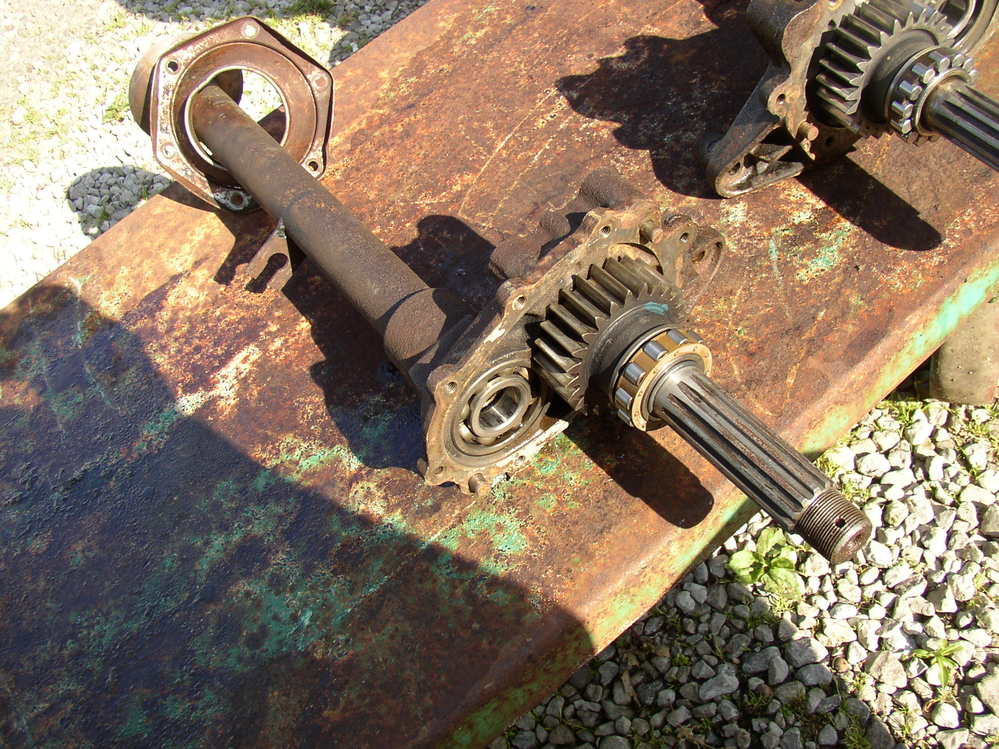

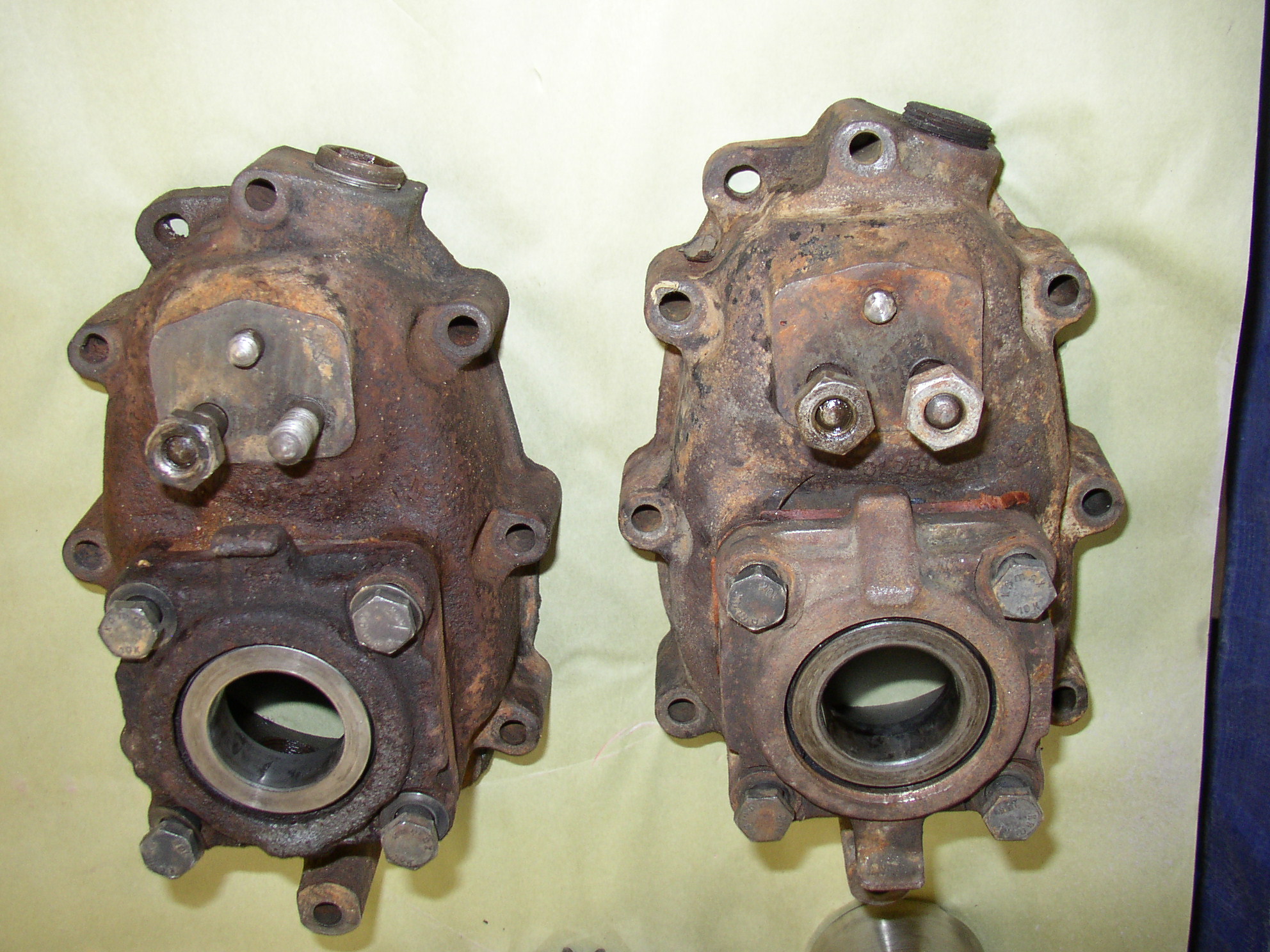

I bought a spare "supposedly good" (?) tranny last year with the axles off, now I'm trying to make this basket case a tranny again. :roll:
Fugly dirt
I spent hours cleaning the grime off the housing, I didn't want to pressure wash it for fear of water intrusion. The good news is that it came from a southern bus, no salt rot at all on the bottom, and a mixture of Georgia red clay and sand stuck all over the case. Tedious time with a scraper, solvent brush and brakeclean to finish it off.
Does anyone know were to buy the axle tube retainer O-rings? (not side cover O-rings) These don't come in the tranny gasket kit and WW doesn't show them. Also, where do you buy tranny inside parts? WW only shows really early tranny parts.

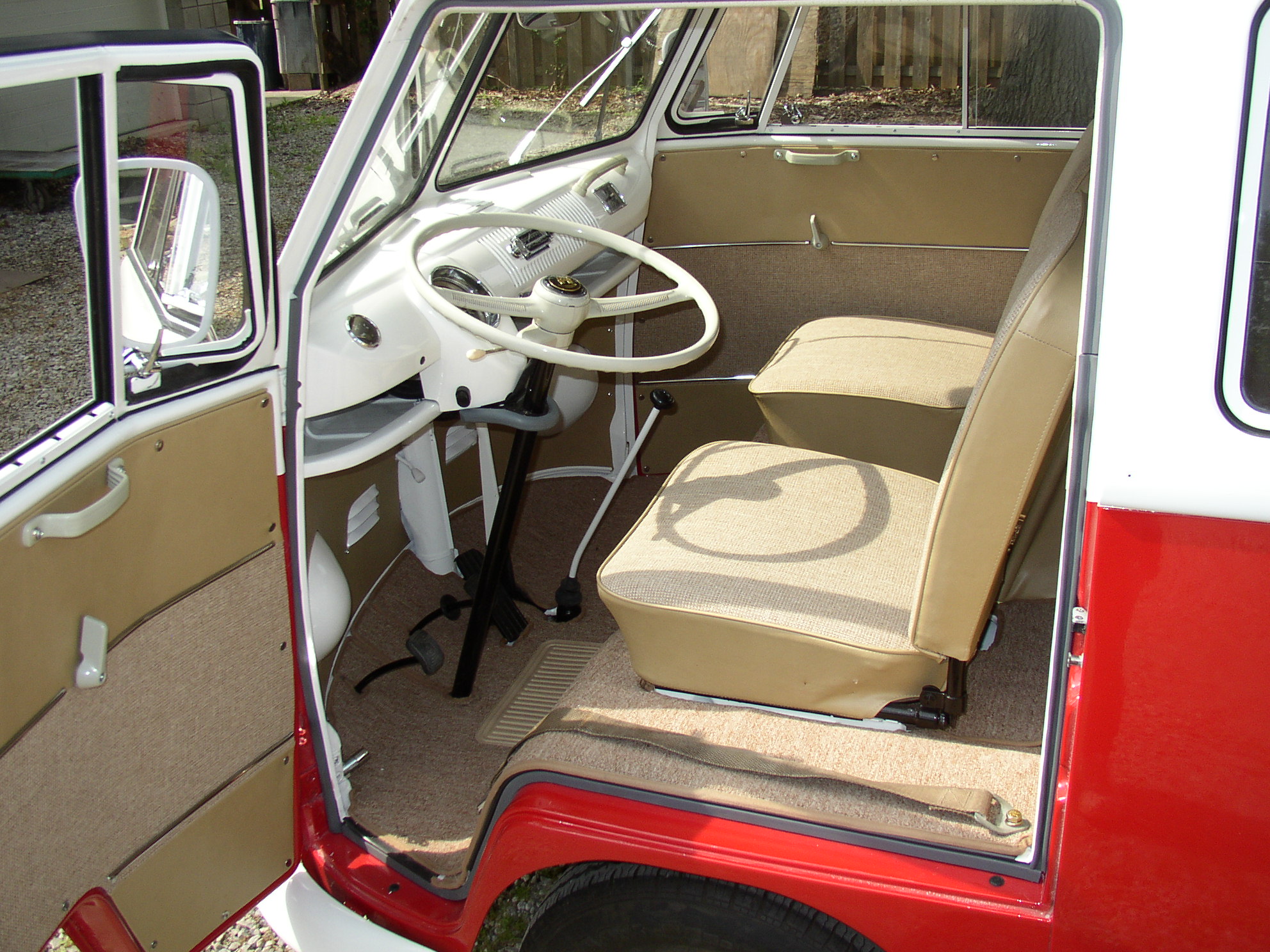

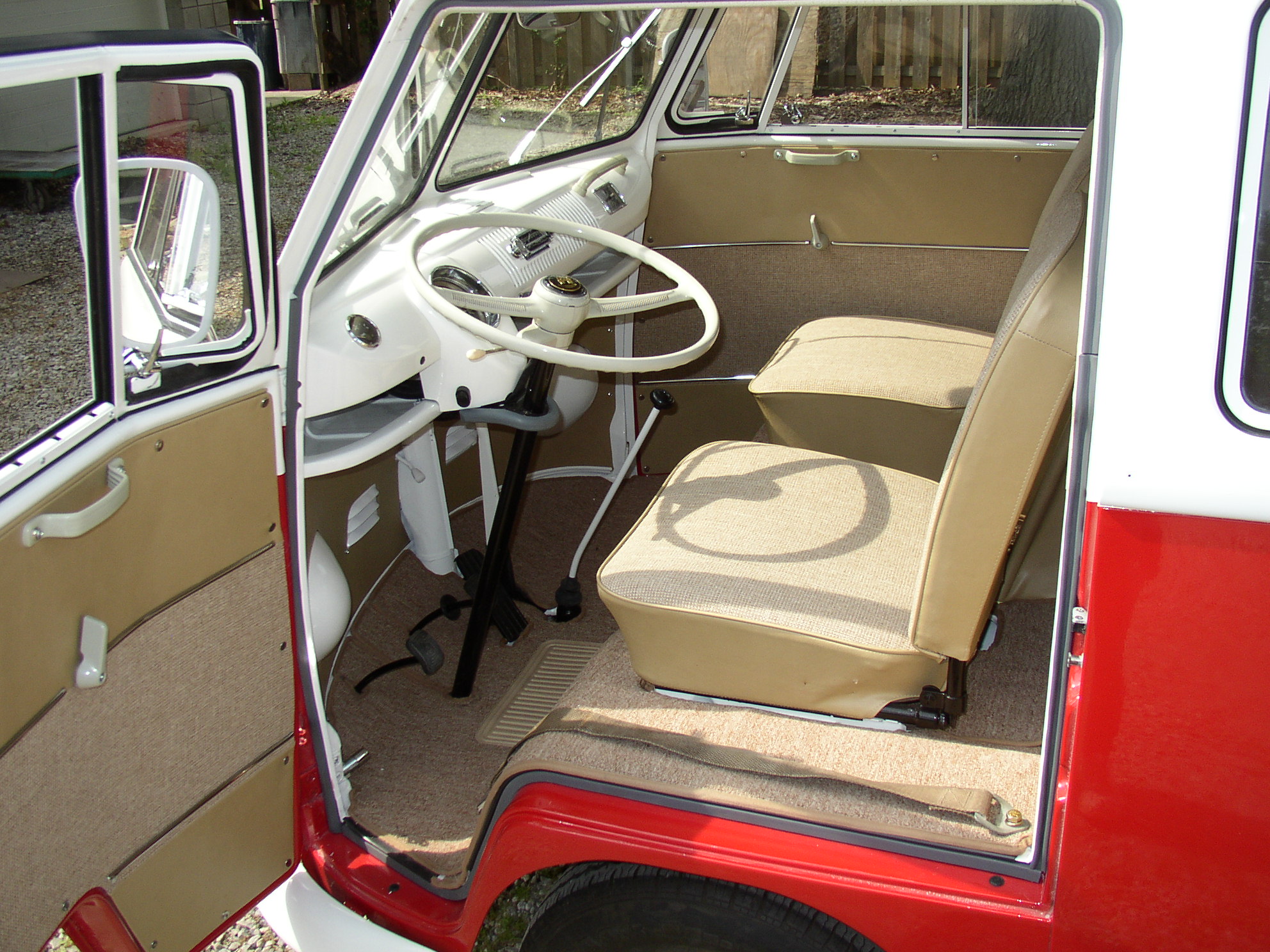

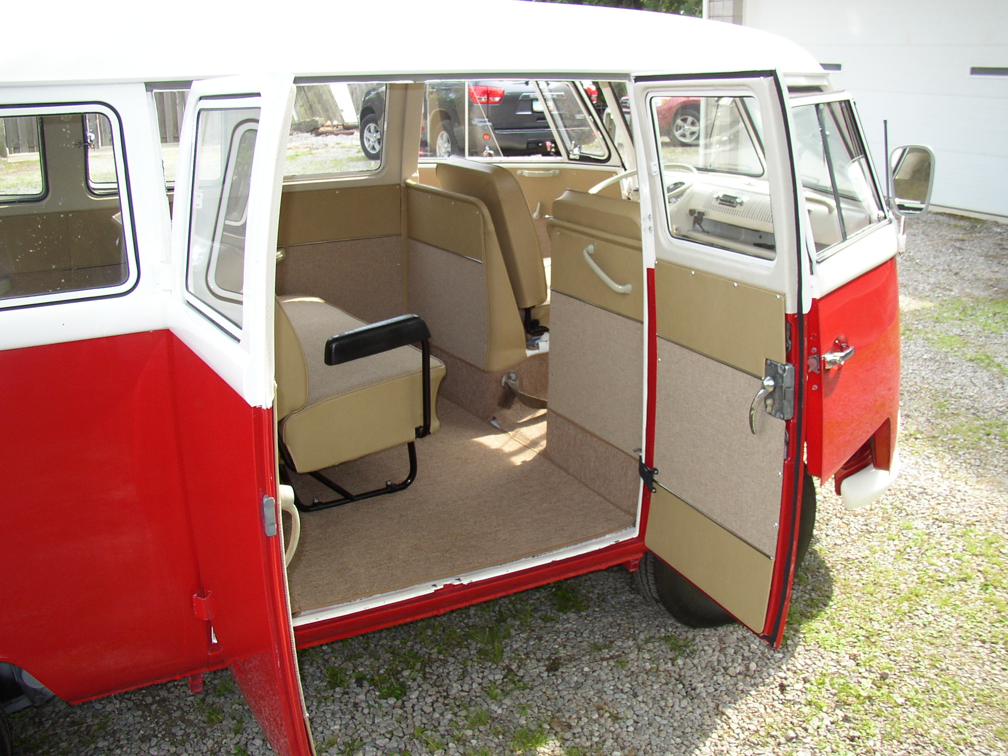

I've done a few things, time for an update. Many of you have seen the bus lately at cruises and events but not everyone. First of all, I completed painting the LF door window frame and installed it, which went much smoother than the RF for obvious reasons. I installed the door panel which also went much smoother. I also installed the weatherstripping around all doors.
The interior is looking quite nice.
The weatherstrips from WW for the front doors, rear hatch, and engine lid all fit perfectly. The weatherstripping for the cargo doors was too thick and skewed the door alignment so badly I had to remove it and use Home Depot generic stuff, which actually fit quite nicely. The Samba guys bitch about the same thing.
The rear carpet is finished off and the rear seat installed, I found out the hard way the seat back has to be installed before the seat base. :oops:
