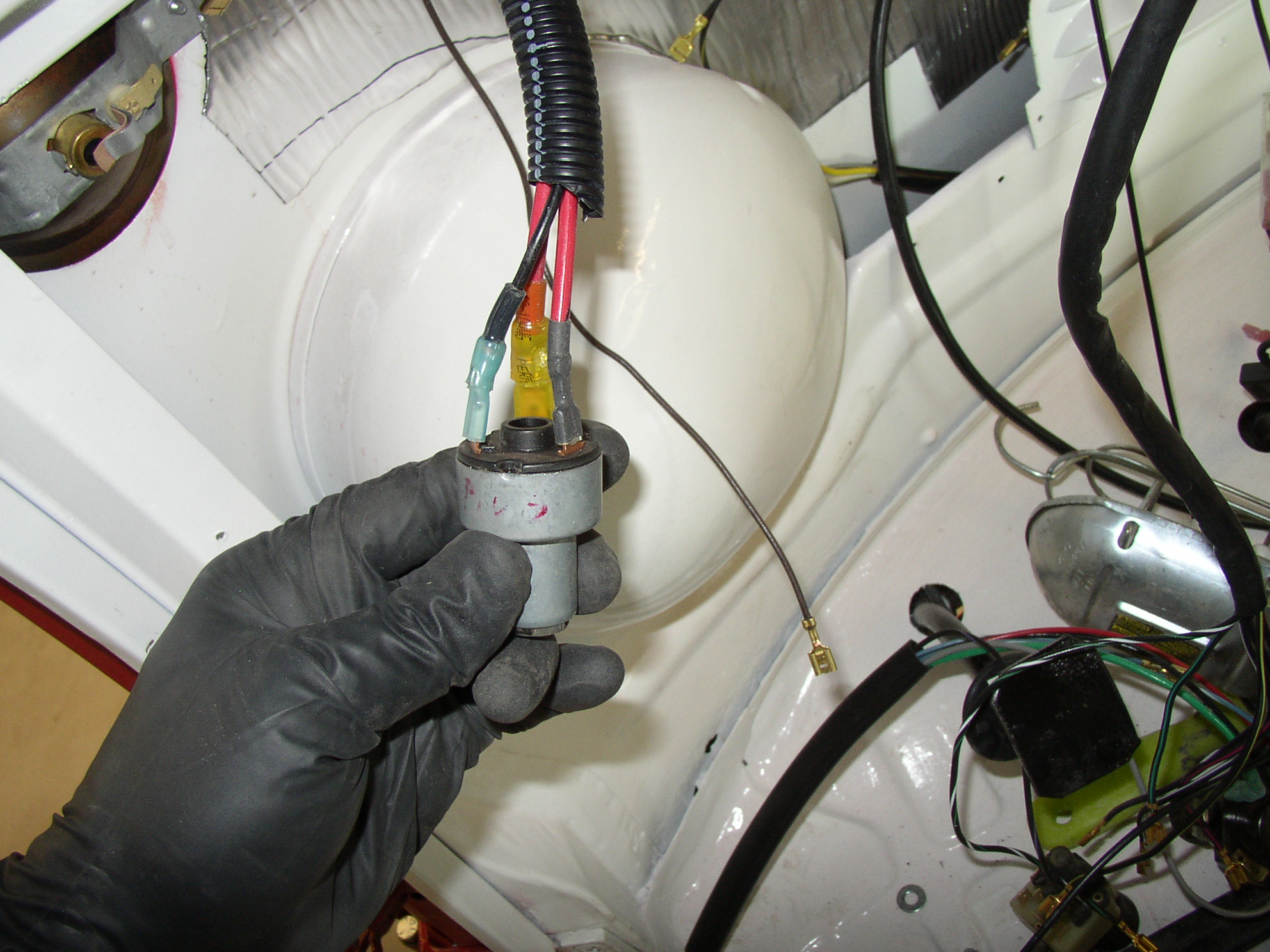

I made a lot of progress this week even though I was out of town a couple of days. I installed the clutch cable, modified the Bowden tube slightly, throwout brng, starter, harness, etc. I put a 40amp Maxifuse in the power feed that heads up front to prevent shorts from burning the bus down. I suggest everyone consider this. I can't believe VW never put circuit protection in millions of cars, they'd all be recalled if they did that today. I don't know of any current mfr that doesn't use a fuse or fusible link in their main power feed. VW doesn't fuse the front parking lights, either, a short up there melts the wires.
There's a weather cover for the fuseholder, too. I'll put a 15A fuse up front in the coil feed circuit, too, when I'm up there. You see I also put shrink tube on the female hot spades for protection. I use sealed crimp connectors almost exclusively, they're expensive but worth it.

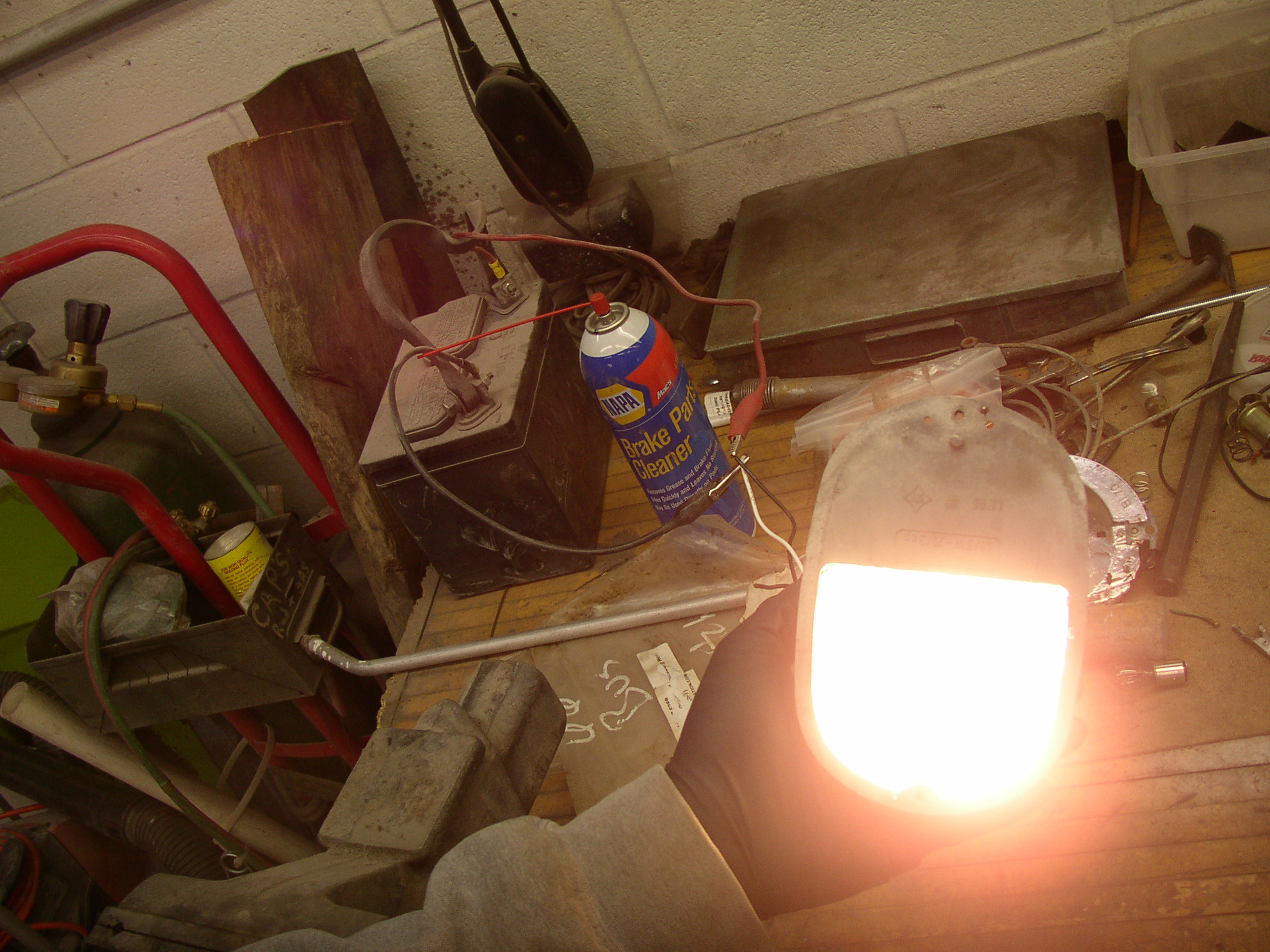

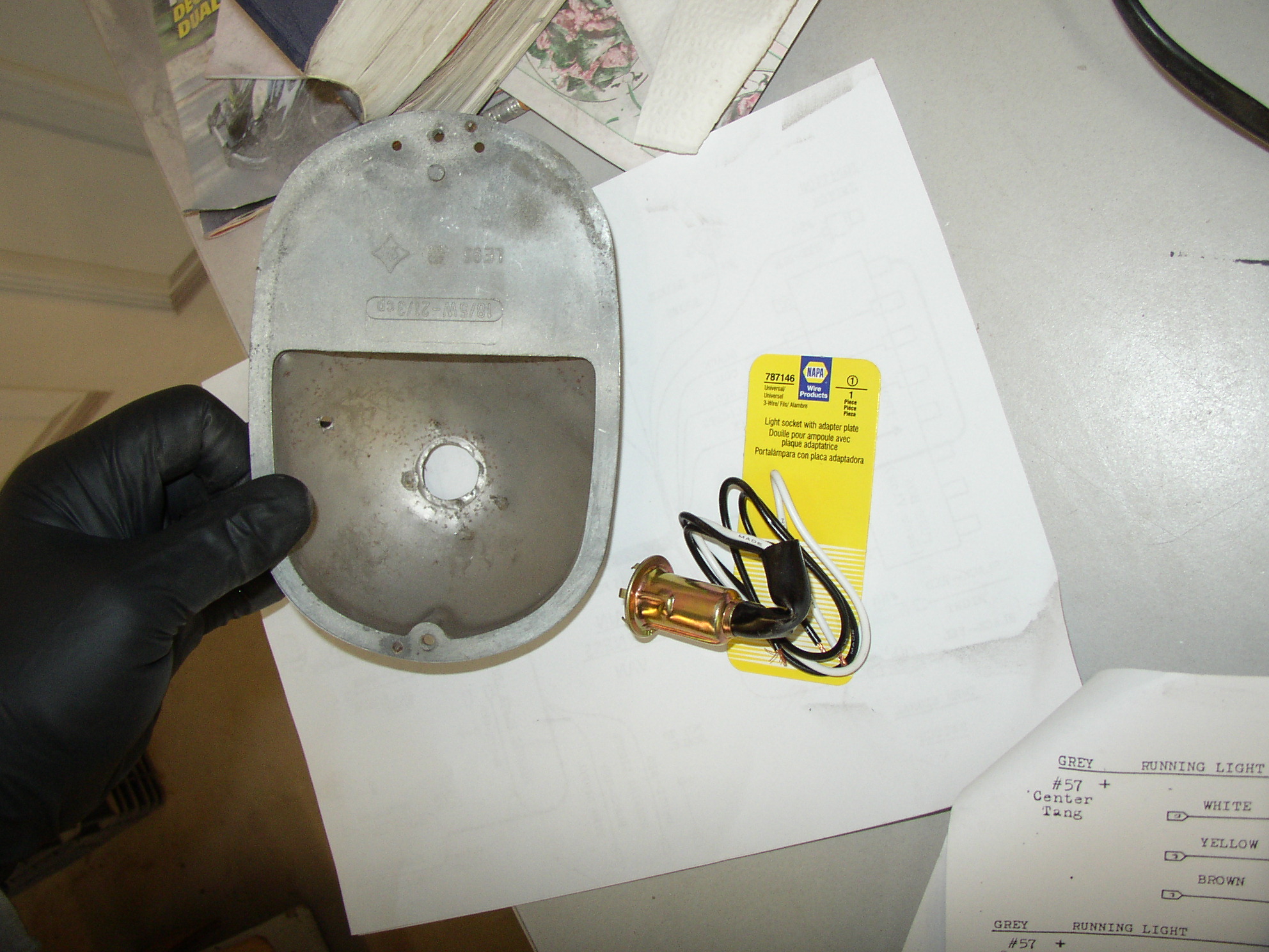

Over the last couple of days I restored the rear taillight assys, front TS assemblies, installed the headlights, installed the battery and fabbed a strap. Today I got the dash wiring pretty much complete, the speedo head back in and the dash tray in. All lights work, all warning lights, high/low, tail, stop, turn signals, horn, etc. I had 3 frigging bad brake light switches in a row! Good thing I have 5 on the shelf.
I put an accessory fusebox in place in addition to the OEG one to spread out loads and put fuses where they need to be. I used a 6 wire '58-'65 turn signal switch and wired it with a modern flasher instead of that antiquated old flasher that mine had, and put a dimmer switch on the floor instead of running them through a relay. The idiot lights work and the gen was pushing 14.5v, perfect.
