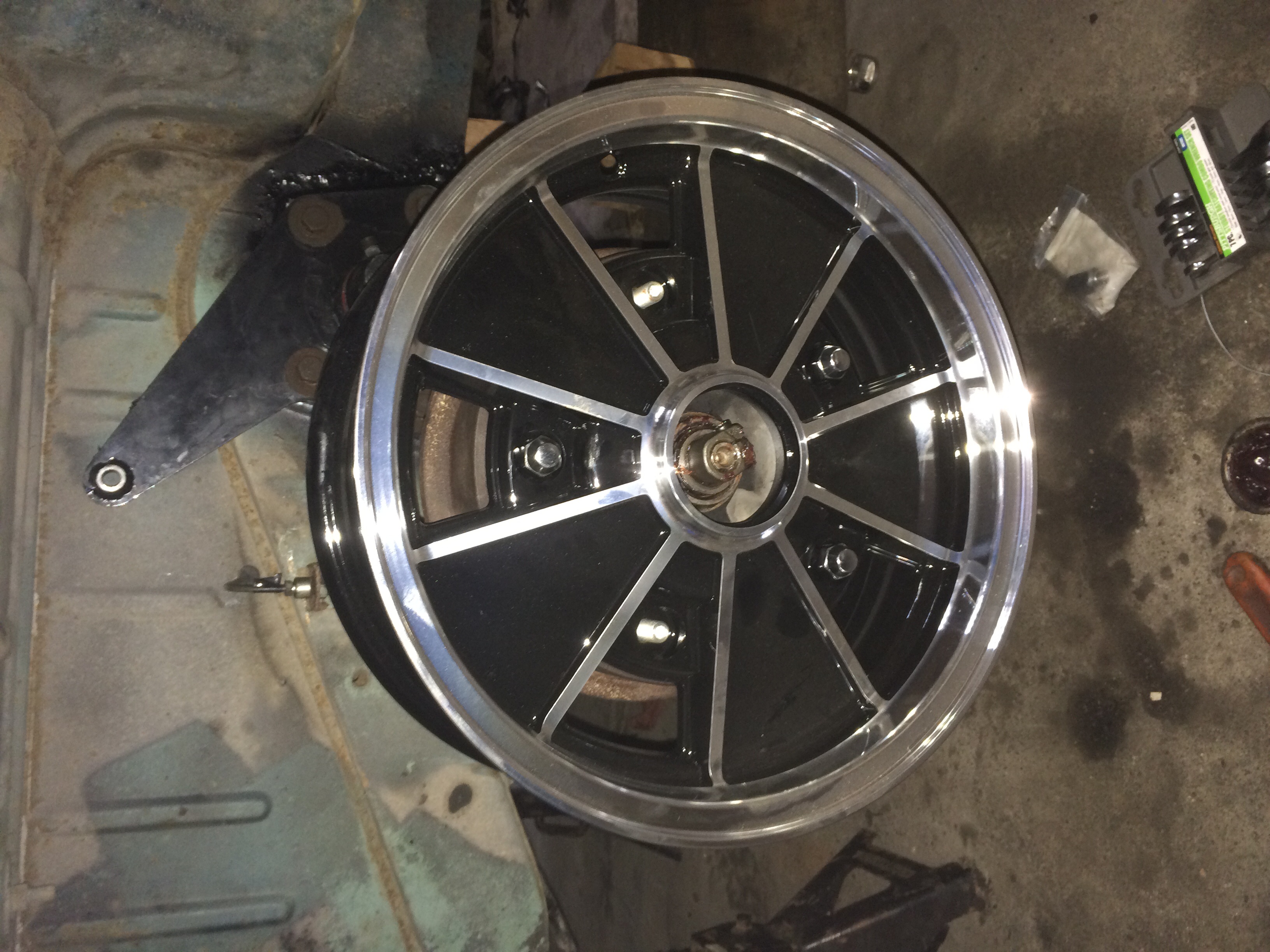

Put just a rim on to how things look. Tires come in early next week.
