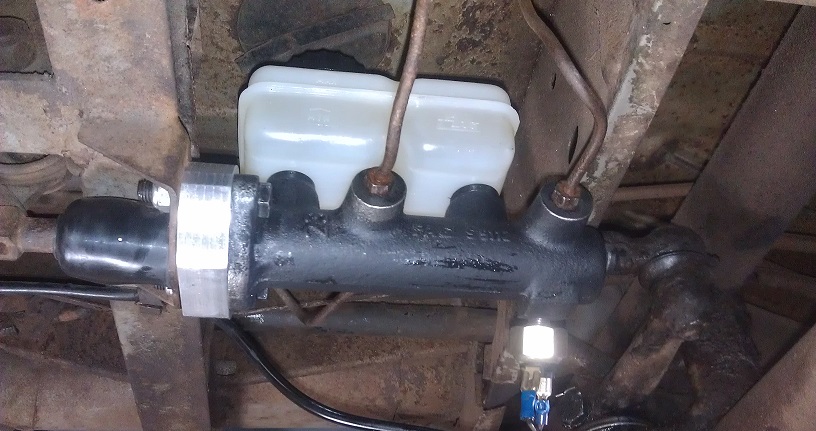

I went to Kirk's yesterday... I picked up a helper on the way. Mike joined in on the fun and helped with the master cylinder install. Thanks Mike!
After the install, bleeding the lines, test drive, bleeding the lines some more etc... it was good to go! I drove him home yesterday. :D The engine ran great, other then some electrical issues, and cleaning I think I am ready to go for the season.
Here is a pic of the master cylinder install. It is definiately not as pretty and clean under my bus as Bruce's but then again... who's is?
Nice job. Dual MC looks good. Now I know why Mike wasn't home when I rolled by his place yesterday!
