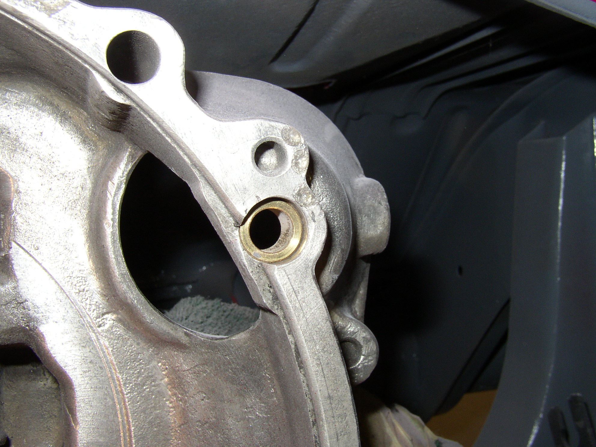

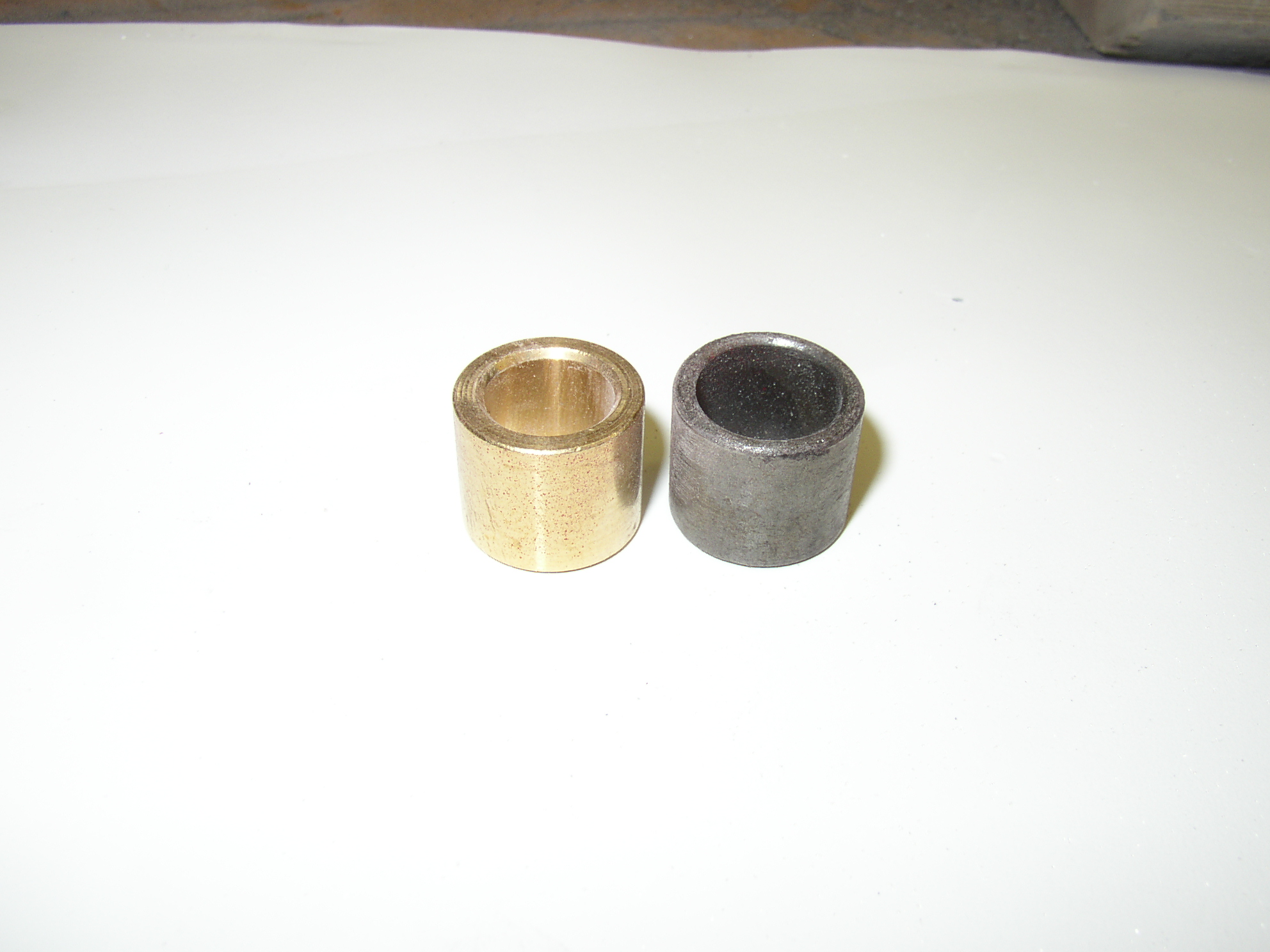

Put the adapter bushing in for the starter,

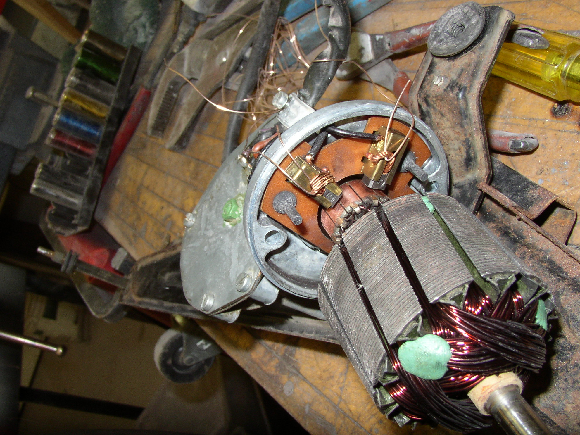

I disassembled the wiper motor, cleaned and re-greased both areas and bearings, and gently wire wheeled the commutator.
I hear bad things about sandpaper and commutators so I've always used a wire wheel with good luck. (Chuck- 3/8" drill, small wheel gently, not the monster flesh remover)
You need three hands to reassemble one of these so I used some mig wire to hold the brushes back while the case goes together. I hooked it to a battery and ran it through the paces for 90 minutes when done, it works perfect on both speeds and park and very quiet. I also worked lube into all of the pivots and down the wiper shafts.

I would like to know where I can go to get a 6v transaxle machined for the 12v flywheel like you have done, Bruce.

douge wrote:I would like to know where I can go to get a 6v transaxle machined for the 12v flywheel like you have done, Bruce.
I made the tool, you can use it, Bill donated a couple of bearings to hold the crank. It takes about 10 minutes and looks really nice compared to the old butcher method we used to use.
