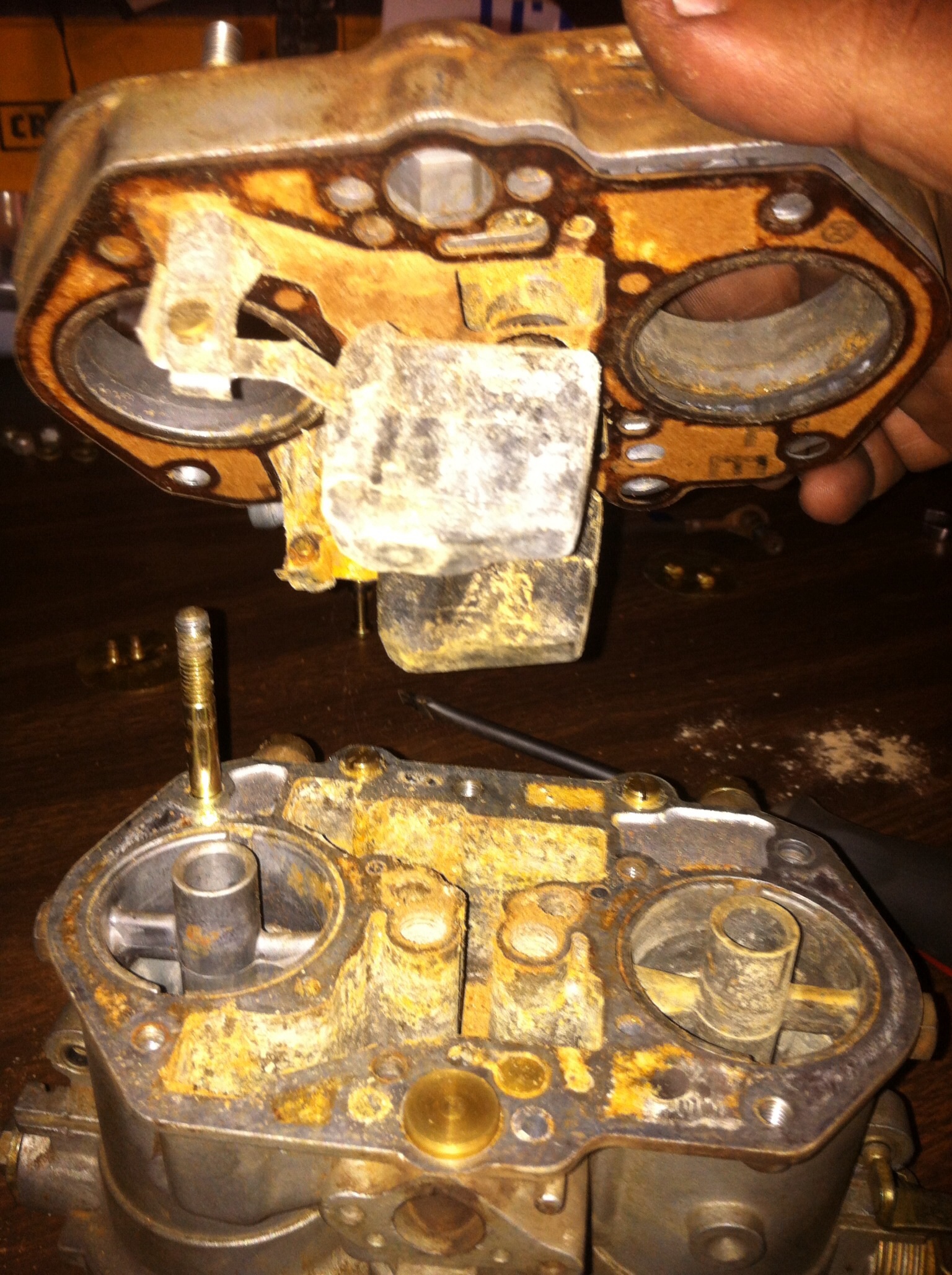

So I picked up these dual 40 DRLA Delortos and before anyone says 40s are to big don't worry, venturis and jets swap out for smaller sizes in 2 minutes. But they came super dirty and crusty. I was looking into ways to clean them up and I came across this article: http://www.aircooledtech.com/tools-on-t ... a_blaster/ on Nates Aircooled Tech website (which is great!) for a homemade soda blaster and Wooow! Did they clean up like brand new or what! I got rebuild kits for them and the CB performance book on them which and helps you pick out the the right jets and venturis for your set up. So here are a few pictures of the clean up. Not much other work on the bus, I was on a big project at work that came between Bulli Brigade and I (which won't happen again I promise). And then last week I finally got my tonsils out so I've been doped up on pain killers, eating soft foods, and stuck at home. But now that I'm feeling better I'm ready to get werk. Also decided to try my hand at metal work and attempt to replace the cargo door inner and outer rocker panels. I think I will try some Autocraft metal from ECC. Have a nice Turkey Day!

Well do youself a favor and sell them now....
because
While dellortos are the best carb made in my opinion they suck for a bus...and heres why. The idle jets are in the top so they are a PITA to get to in a bus since you cant get to the top.
You could put a type 3 hatch back there and then it would be worth it...otherwise get some weber DCNF's, or some 40 idfs
but no kadrons those suck on anything
But if your dead set on making your bus life miserable do yourself another favor and call CB performance back and get the update kits they make for them....it makes the perfect carb even more perfect.

vw7266 wrote:Well do youself a favor and sell them now
I wondered about that. Well if they dont work out. I assume i can trade them or sell them and get some some webbys. And yes, i do have the update kit installed :D
