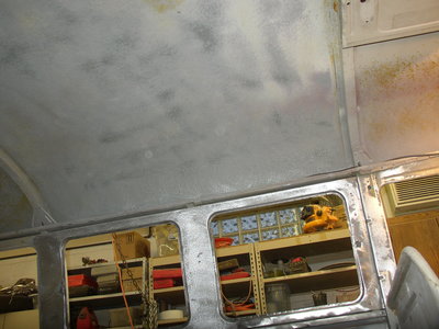

The glue is gone from inside the roof and the inner window openings are clean. It was not a big deal, easier than I thought it would be. The bitch was cleaning the floor- scraping all of the black tar-asphalt gunk that's glued in the luggage area, and wirewheeling the main floor area. That was a PITA! There was also a couple hours grinding welds on the left side floor that never got ground out.
The roof is ready for primer, I bought some regular Napa seam sealer and tested it, it sets up fairly quickly. It says over paint or bare metal, so I'll probably put it on the bare metal. As little moisture as this bus will see, it will be hard to do it wrong.
I'll seal the welds with FG gel on the left rocker seam and start looking at the front floors.

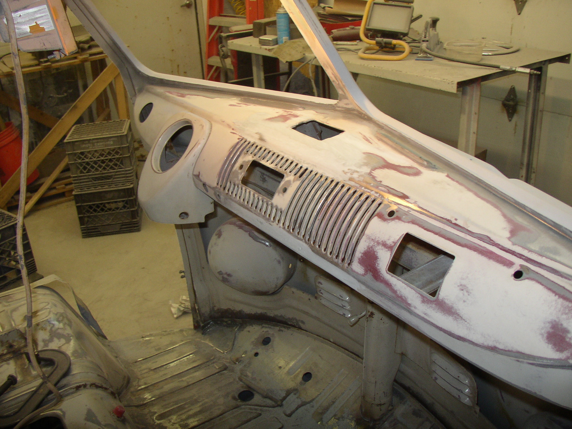

Another update: Once again, lots of hours but not a lot that shows up in pics. I wirewheeled the front floor/seat area to get ready for paint. I fixed a torn out popout window mount using a donor piece from a trashed door. Note it was brazed from the factory. I'm surprised how much braze I see all over this bus from Wolfsburg
It's the one just behind the driver that is backwards, giving the mount more tension. I wonder why some popout mounts are flush and adjustable, some are surface mount/spot welded, and some are brazed from the factory- does anyone know?
Anyway, here's the hole as I weld it up using a piece from behind.
Here's the mount finished. Not pretty, but strong. It gets covered up by headliner material anyway.
I sealed the left side seams with FG gel and put a coat of mud on them. More to come. The stars are bondo dust on the camera lens.
I straightened the area where I welded in a new radio mount and started some mud, it will look good when finished.

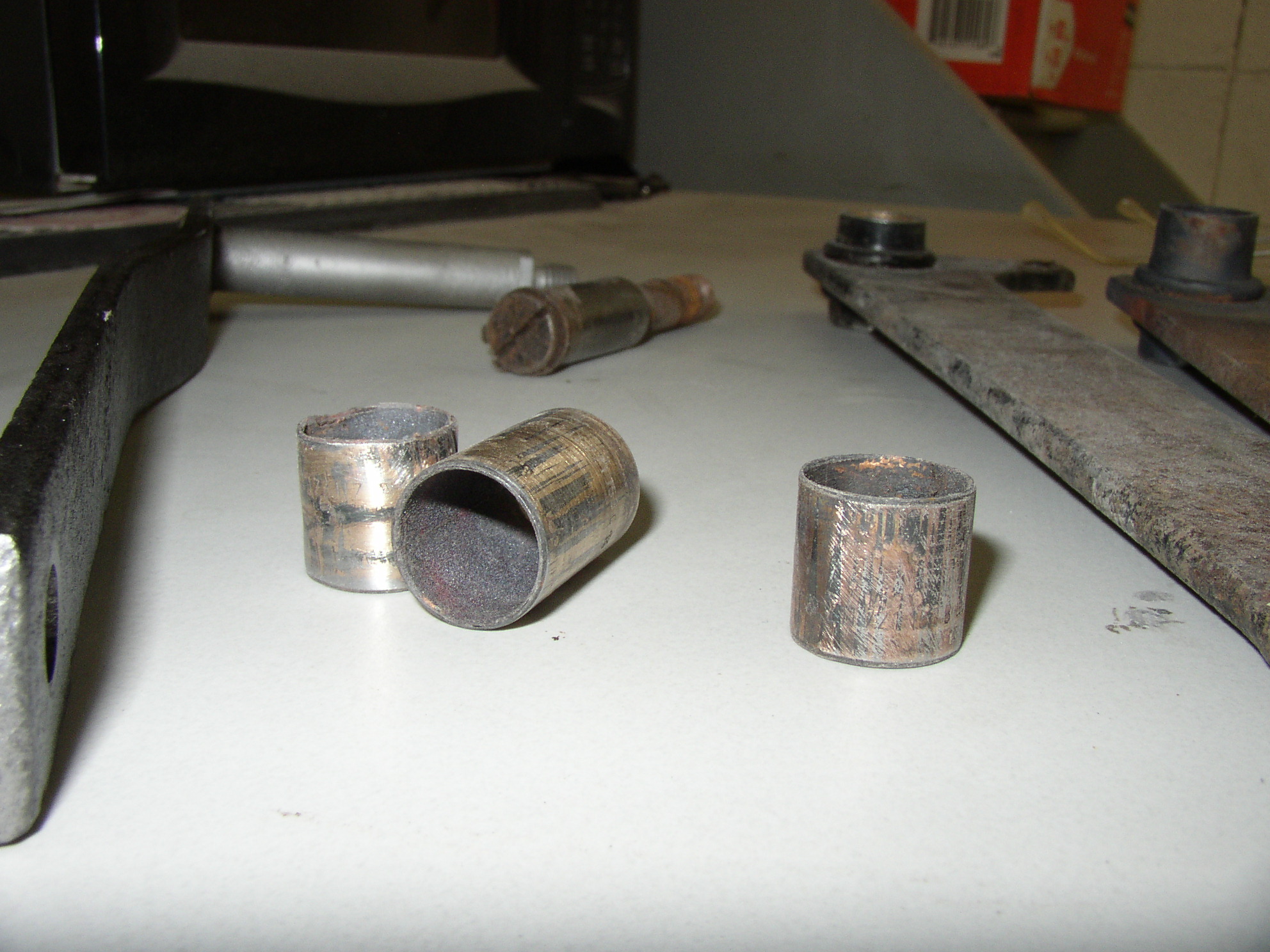

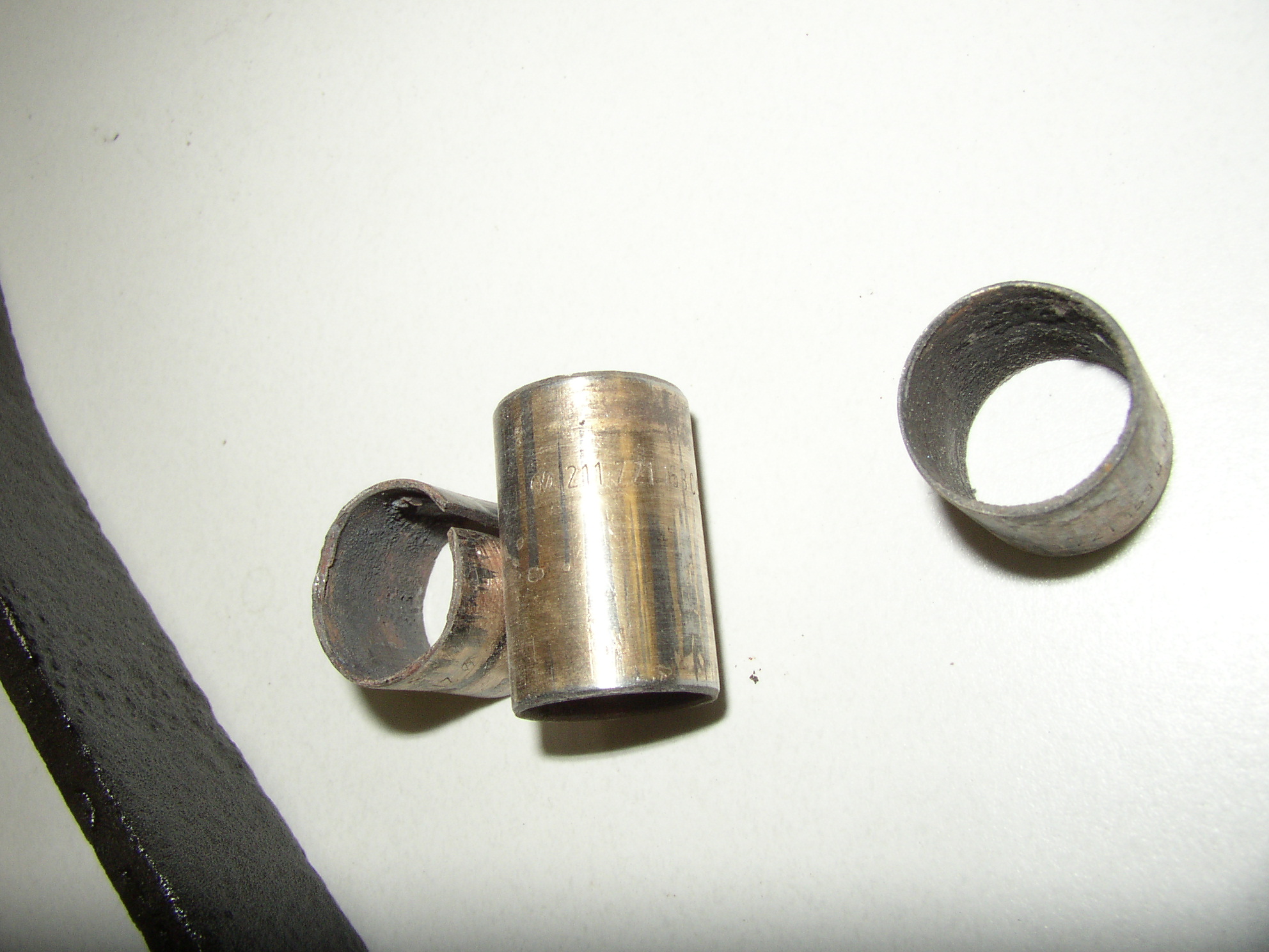

Here's the clutch shaft bushings I referred to in a previous post, you can just make out the PN if you are young and have good eyes.
The short ones are the old CCS, the longer one is the brake pedal pivot, which is the same ID/OD, but almost twice as long. I'm hoping Santa Claus brings me some new ones. ;)
Here's the stuff I got from Kirk, where I robbed the bushing. I might end up putting it back in.
