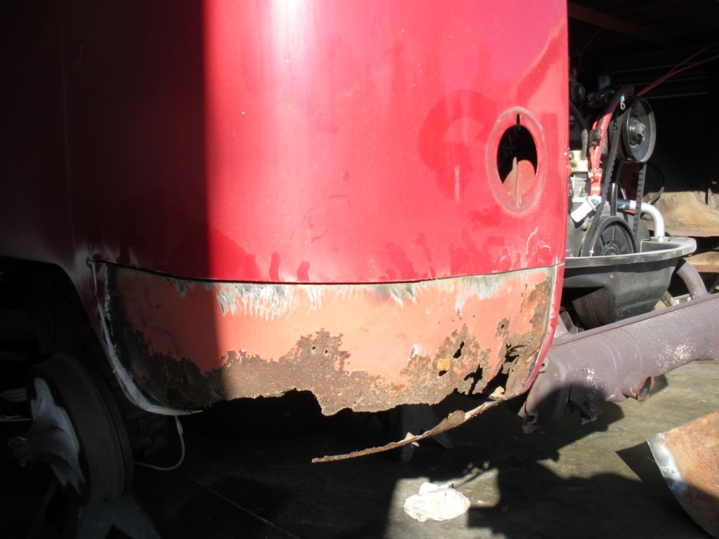

Marla was able to drop the bus off this weekend and we had a chance to take a better look.
The plan is to repair both rear corners and battery tray, plus anything else we find :lol:
At first glance all looks normal...
Underneath, not so good.
Check out how squared off the bottom of the corner is
This is how they repaired stuff before quality replacement metal was available...brazed and 1/2 of bondo to boot :evil:
This is going to be a challenge to make right again...
that will be CAKE! for you :lol: :lol:
If it was easy, everyone would be doing it
I knew there was something going on under there... But this was a bit of a surprise. No worries though. I think I have the right man for the job. If anyone can make Gunther's behind round and solid again, it is Kirk. :)
