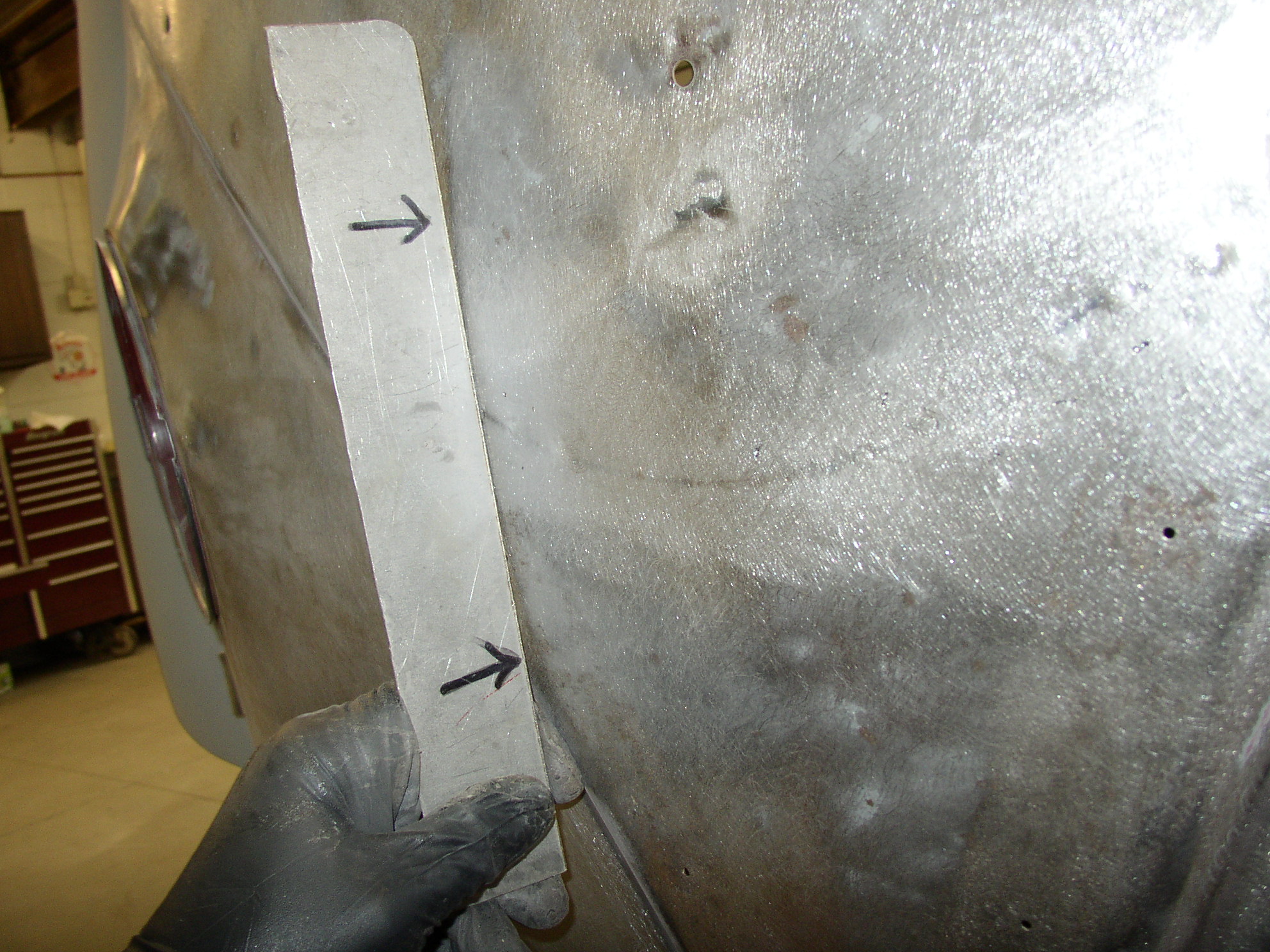

I did use a stud gun to pull several minor dents out of the nose of the bus. This is a cool tool- it welds a nail to the skin, which allows you to pull the dent out when there is no access to the rear side. I'm thinking this dent is from someone bumping the front-mounted spare tire.
Once the nail is secured, a hand puller can be used to pull out the low spots along with a body hammer to lower the high areas around the dent.
If this is not successful, a slide hammer can be called in to provide more brute force.
The results were terrific- here’s a straight edge showing the dent is gone and the correct crown is back in the metal with only a super thin skim coat of filler needed. This one came out so well that high build primer might be all it needs. I use a straight edge as a cheat constantly because it's a lot better than my eyes or fingers.
All in all, the nose is looking really good. There were bunch of holes I welded up including those from a spare tire carrier, several minor dents including some that were right behind the bumper overriders, and other dents. This bus was pretty straight overall, with no major crash repair needed. The lower windshield frames were badly pitted from rot but the metal was still strong, so I sandblasted them very deeply and filled in the pits with epoxy gel. It wasn't bad enough to replace the metal and it came out great. You can see it a bit in this pic but I didn't zoom in on it.
