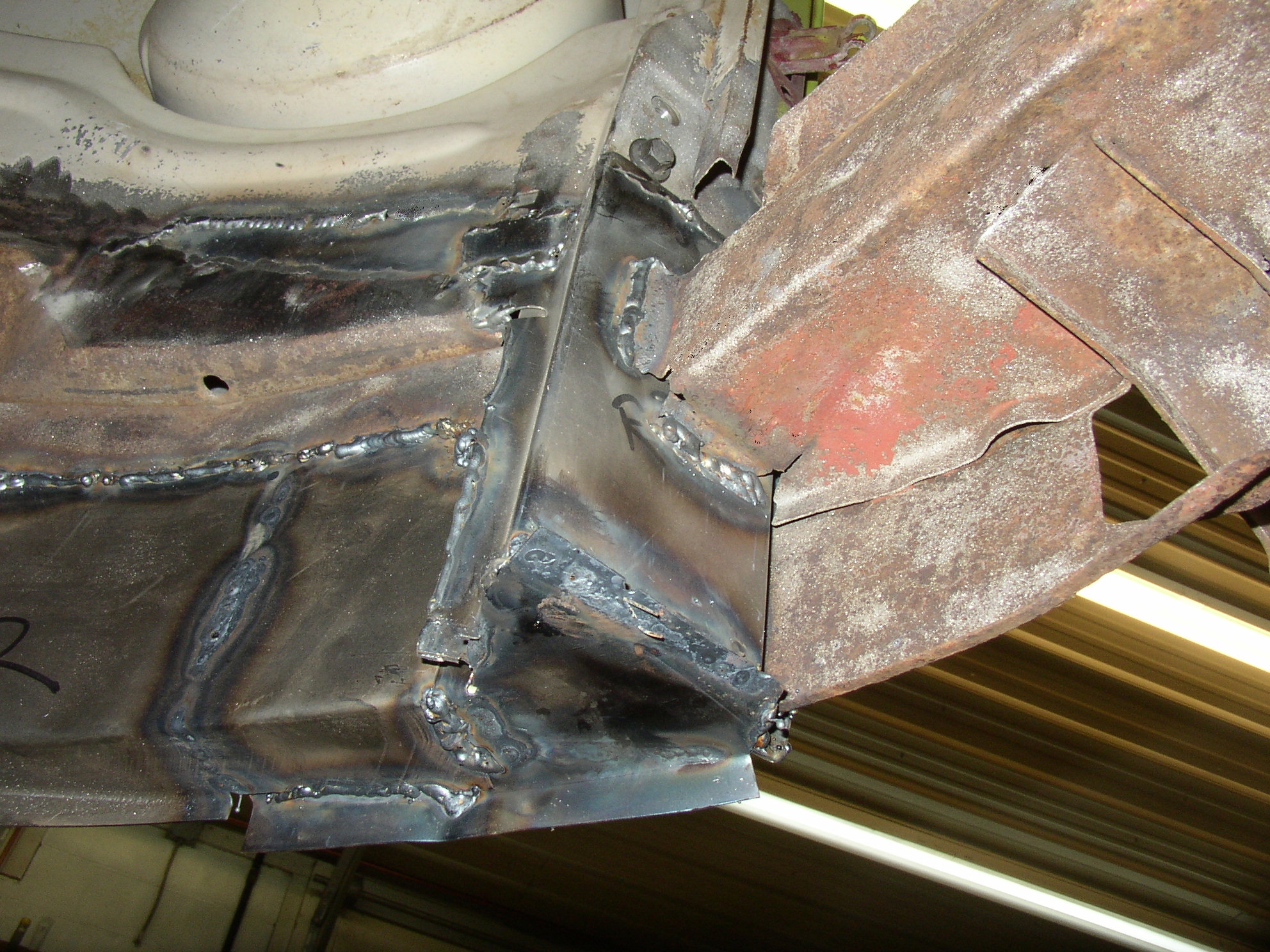

Here's the shots of the inner valance I forgot to post a few days ago. I spliced it using only the lower half, as that makes it easier to change. To replace the whole valance the nose skin must either be cut or removed.
Right floor is done and came out well.

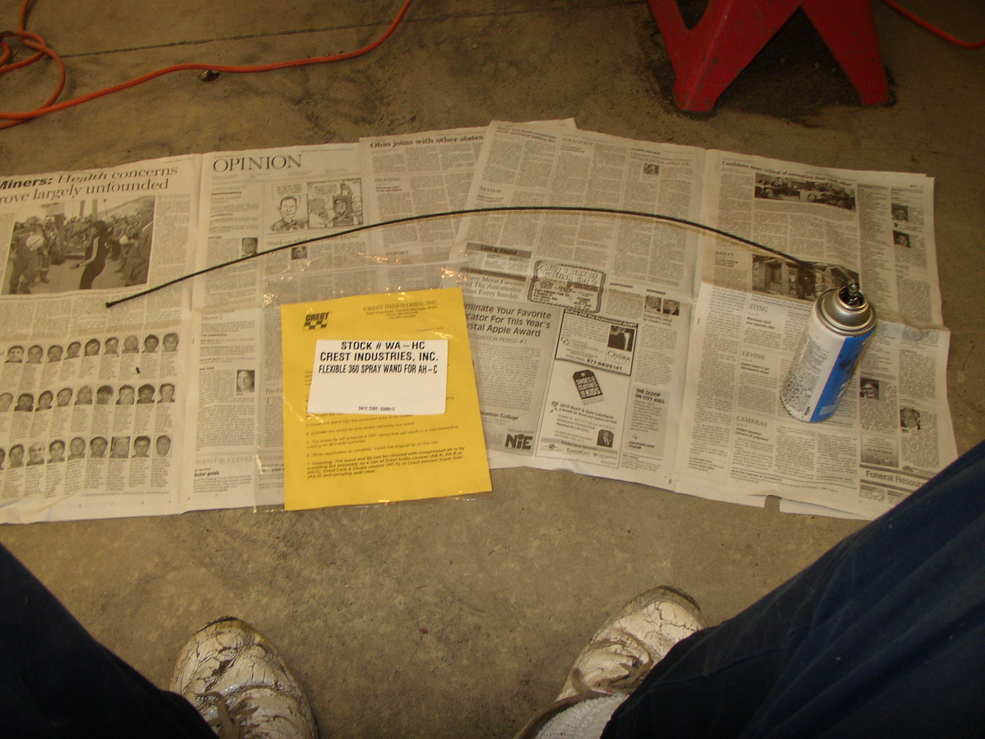

I bought a "wand" for painting inside the doglegs and framerail. It's a 3' tube that plugs into any common paint/rustproofing can with a tip that has 6 ports that spray nearly a 360* circle to coat the inside of stuff.

Fitting the outer valance. Once again, I spliced it and only used the lower half.
Here's where I stopped today- the outer valance is 80% done, just needs final welding.
My buddy's spot welder was the cat's ass for the lower edge- a real time saver.
I'm almost done with major welding, making me one fukking happy camper. I still will need to go around the bus and do final touch-ups with the mig, but all small detail shit. :D

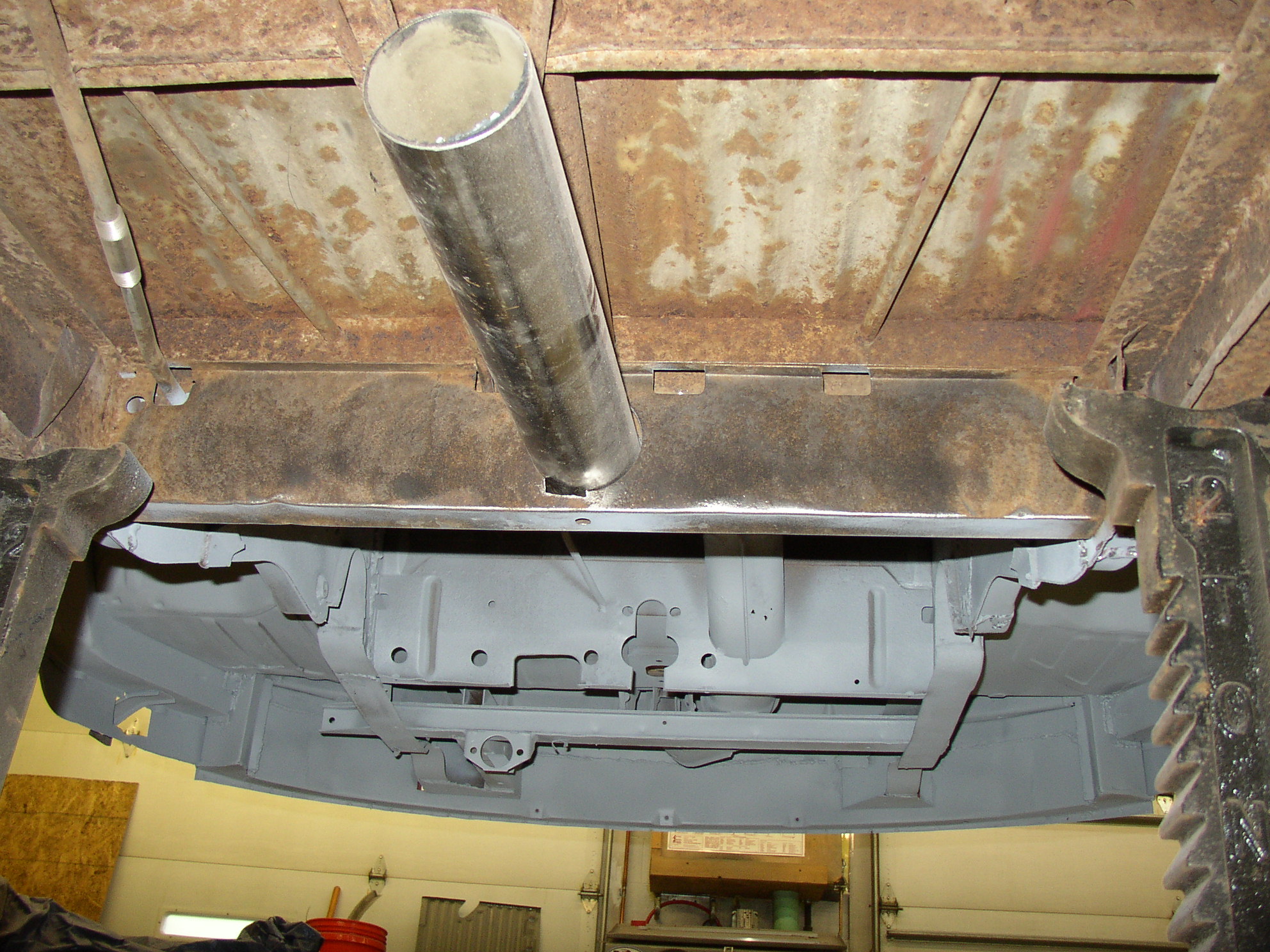

2 3/4" exhaust pipe fits perfect for replacing the rotted long heat tube, it's not easy to buy but Napa was able to get a 10' piece for $30.
Here is a small piece test fitted through the front crossmember and into the bent heater tube.

Replace the rear crossmember (ordered from ECC Tom), installing the heater tube at the same time so it won't have to be spliced. (est 4-6 hours)
