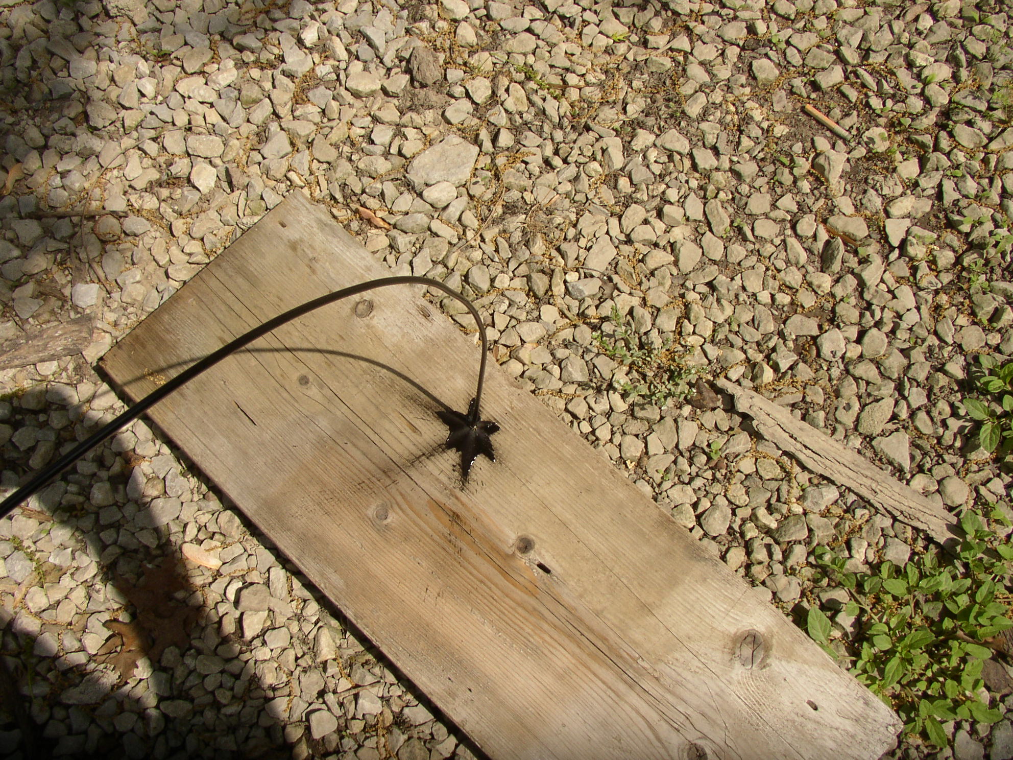

Ken wrote:Bruce
A few posts back you were using a drill to clean out your heated cable tubes.
What kind of bit did you use?
Use an old clutch cable and frey the end a bit, it acts like a wire brush when rotated.

Ken: Yes, I used a piece of wire rope like clutch cable checked into the drill. I actually went to Home Depot and bought a bunch of varying size pieces because I wanted to clean all of the different sized tubes- throttle, pk brk, clutch, etc. An old clutch cable should work fine for all except the throttle cable.

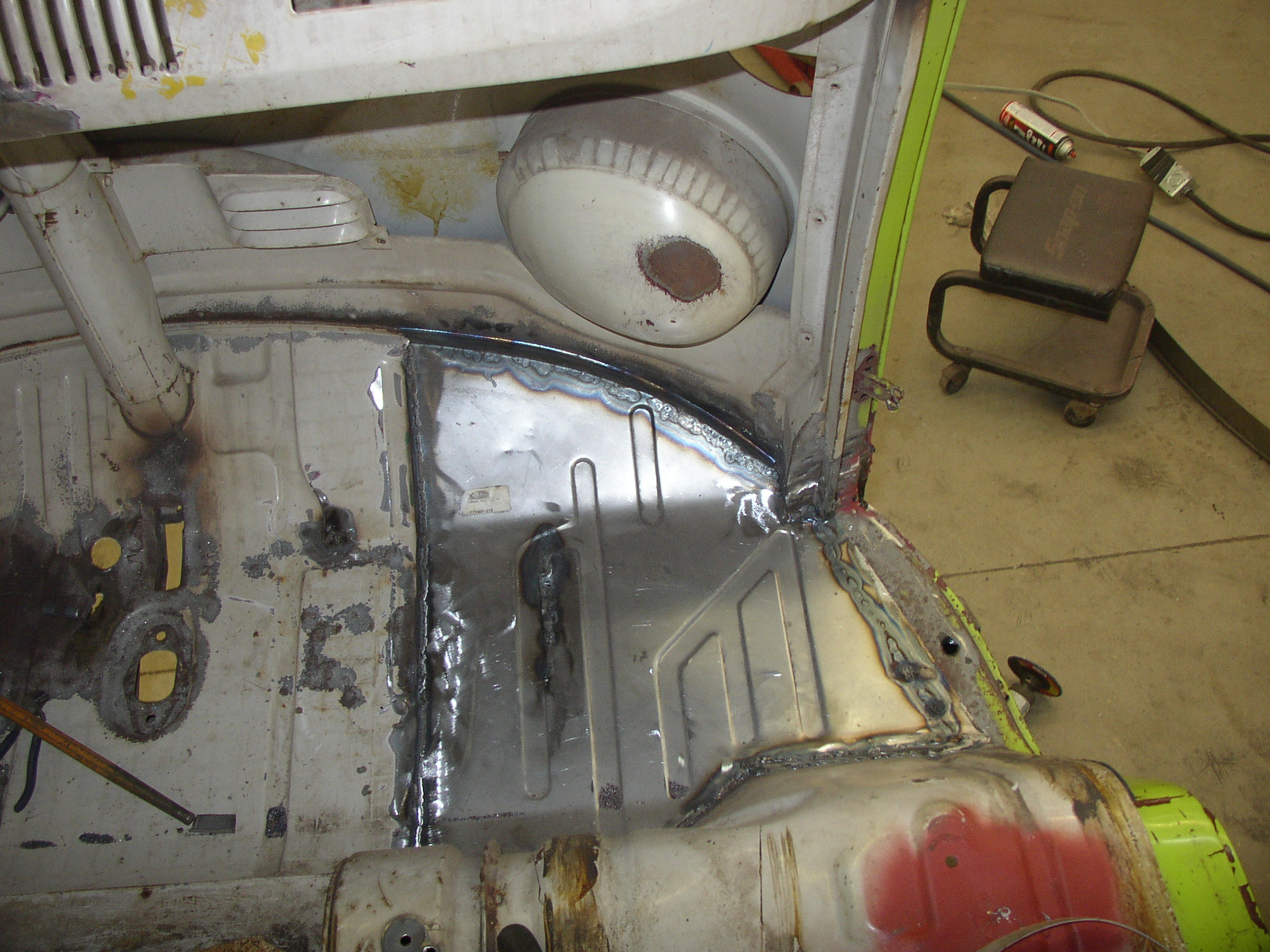

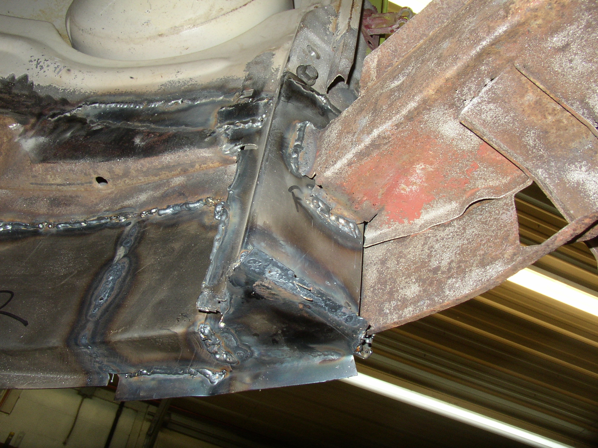

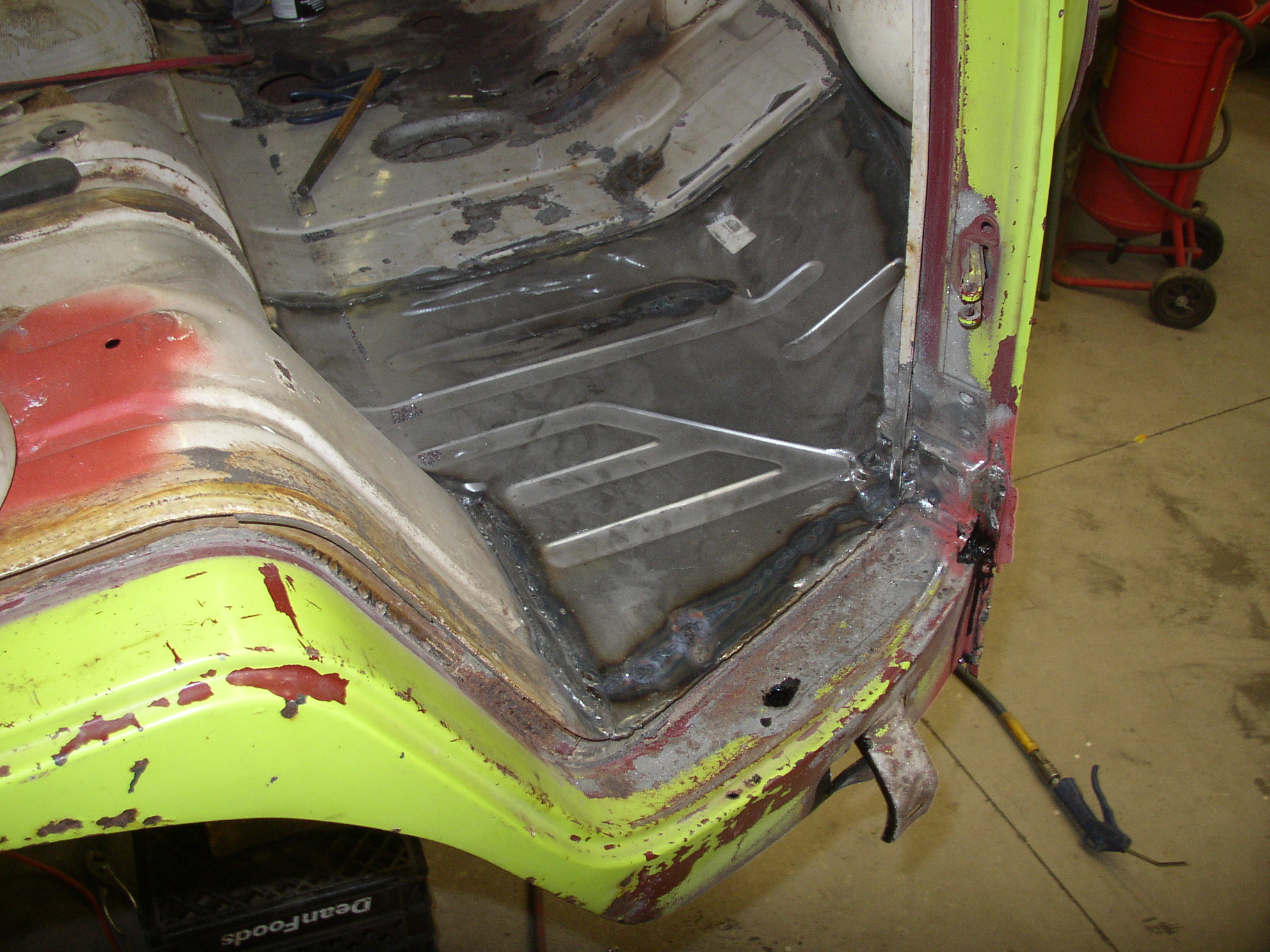

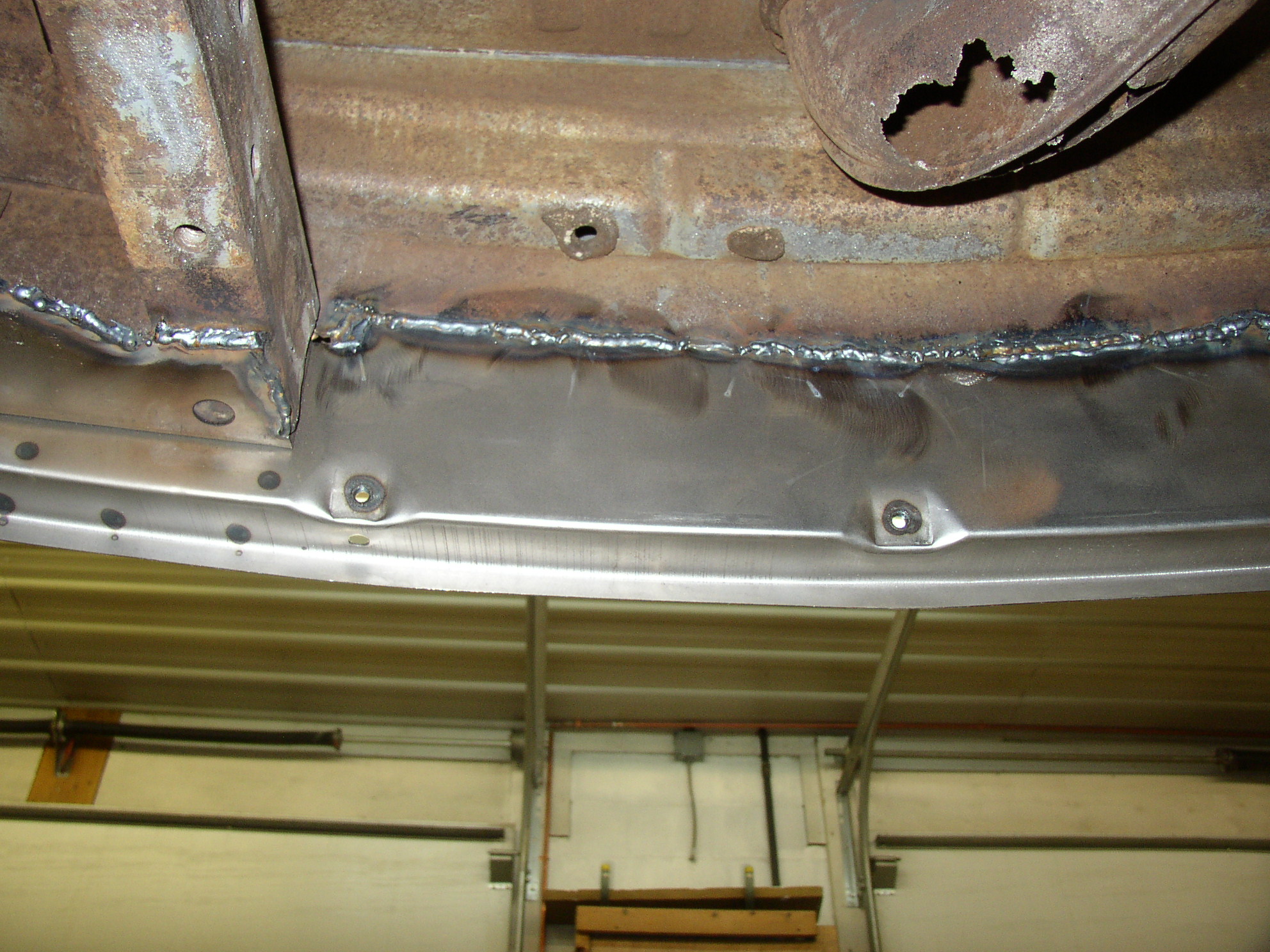

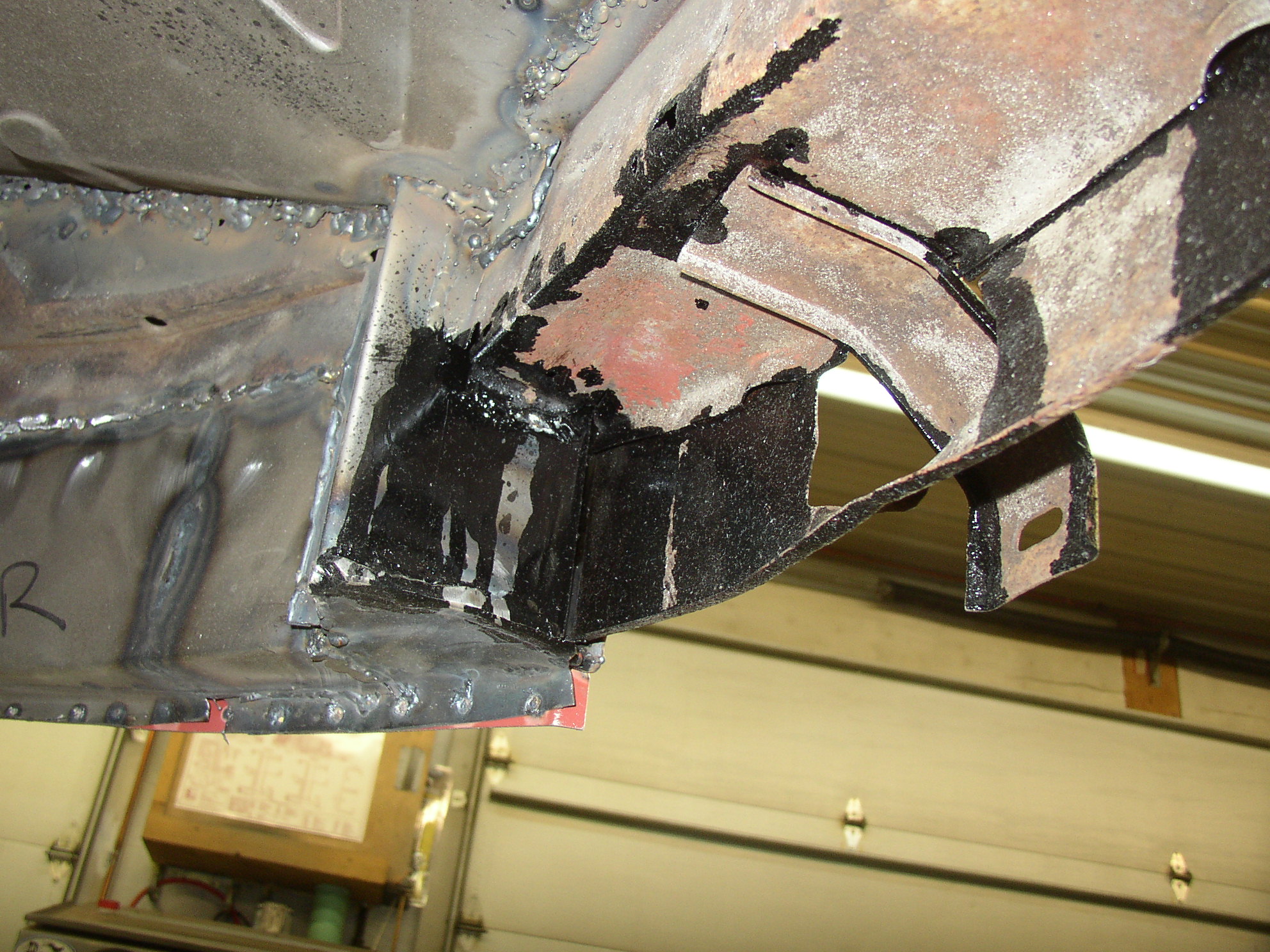

Here's the shots of the inner valance I forgot to post a few days ago. I spliced it using only the lower half, as that makes it easier to change. To replace the whole valance the nose skin must either be cut or removed.

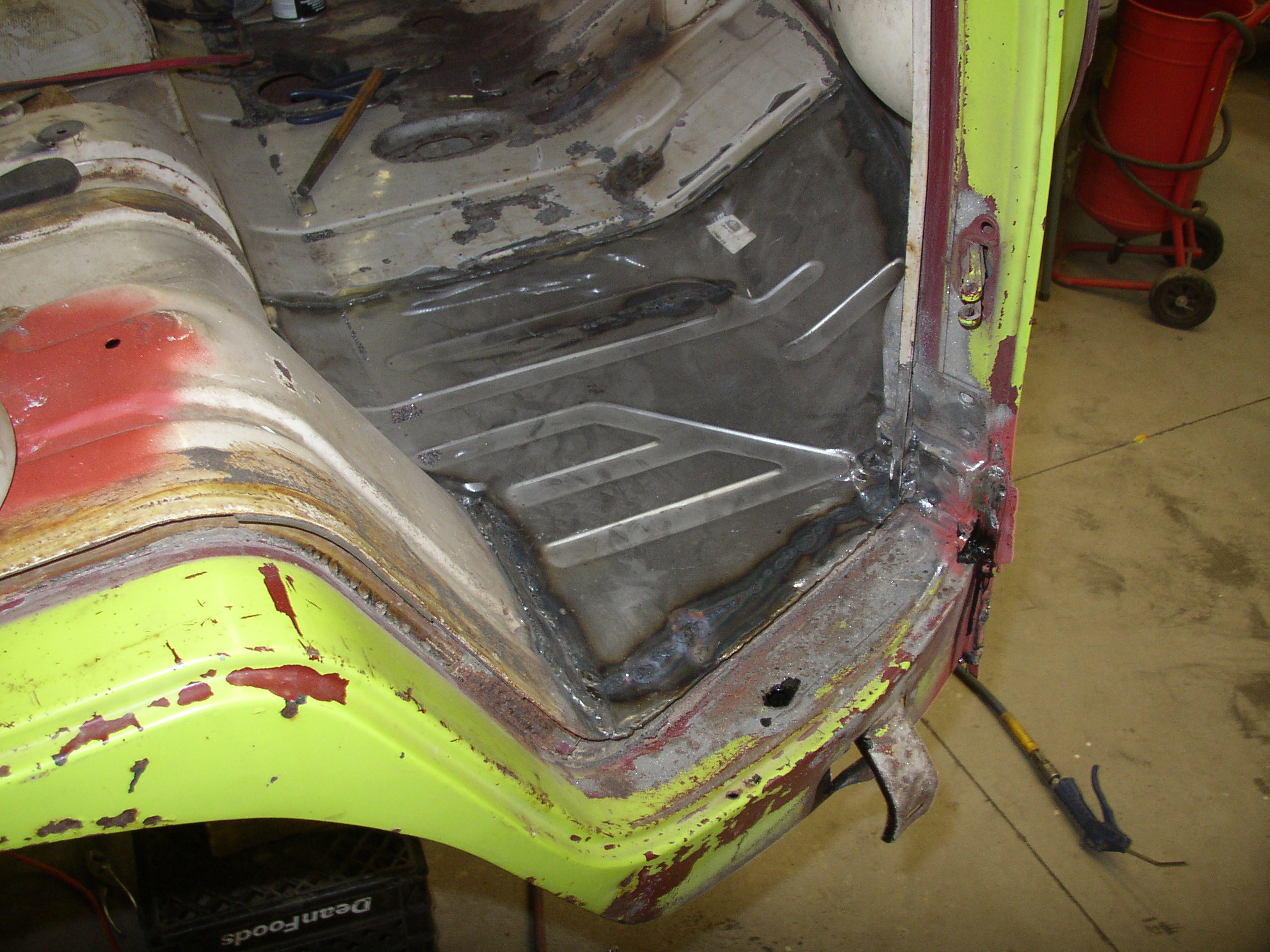

Right floor is done and came out well.

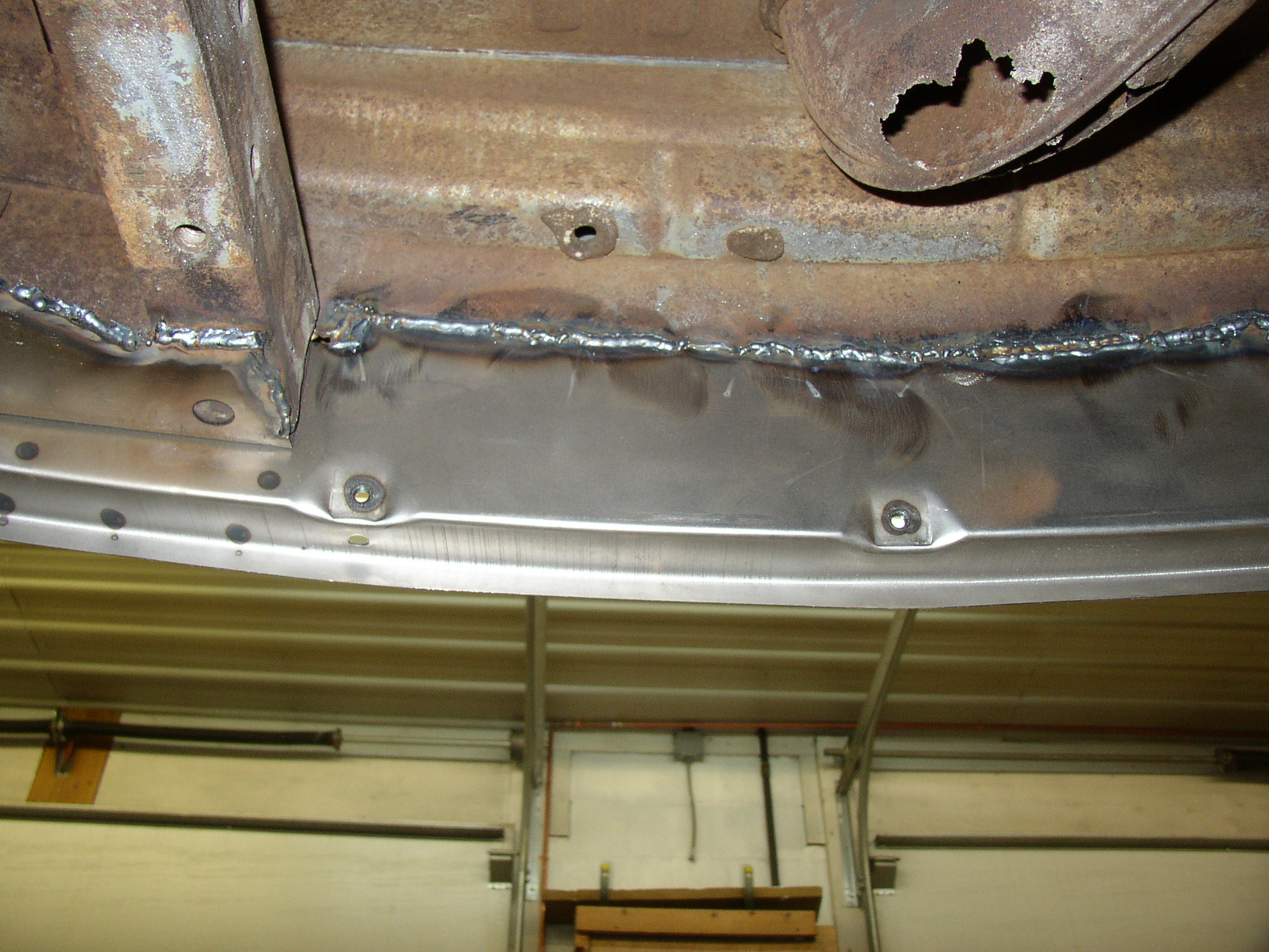

OK, on to the outer valance. Let's hit the inner with a coat of weld through primer first 'cause it's the last time it sees daylight for a while.
I also shot the inner side of the lower outer valance for the same reason.

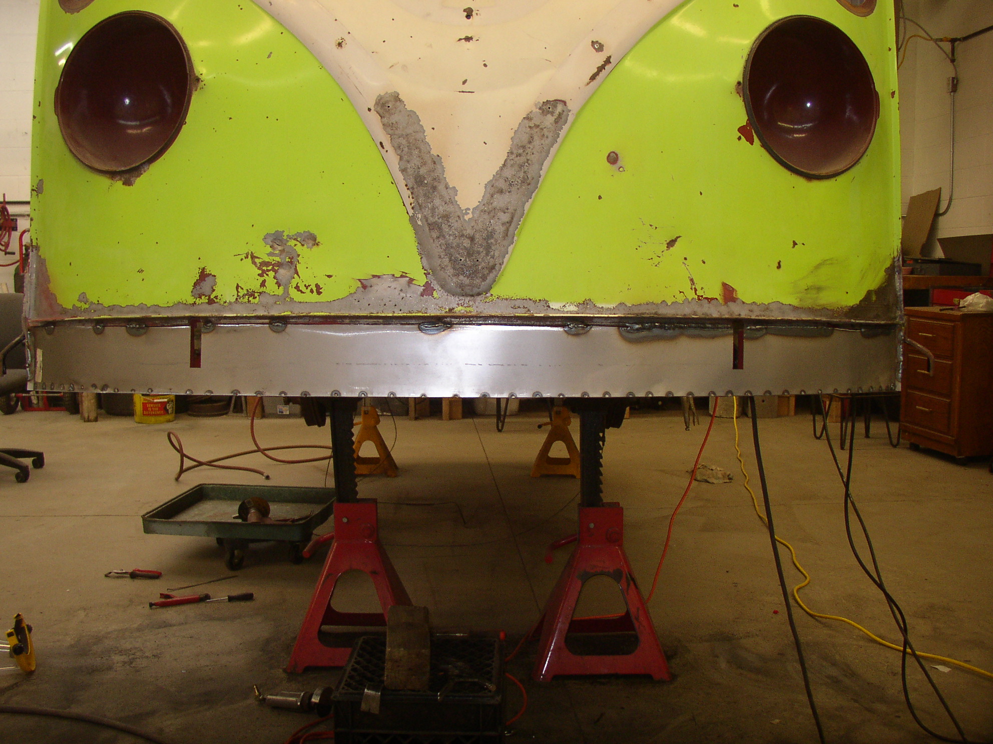

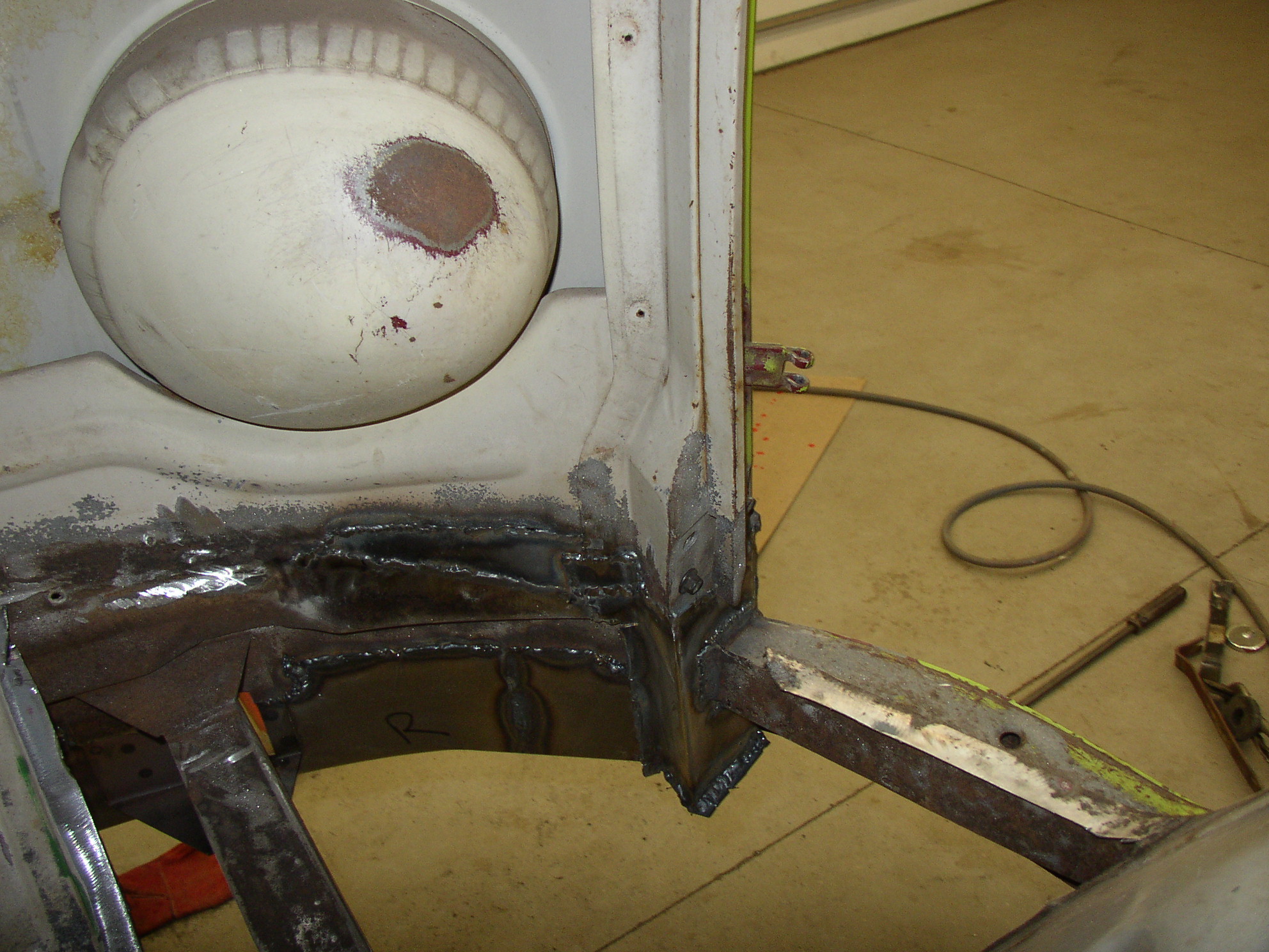

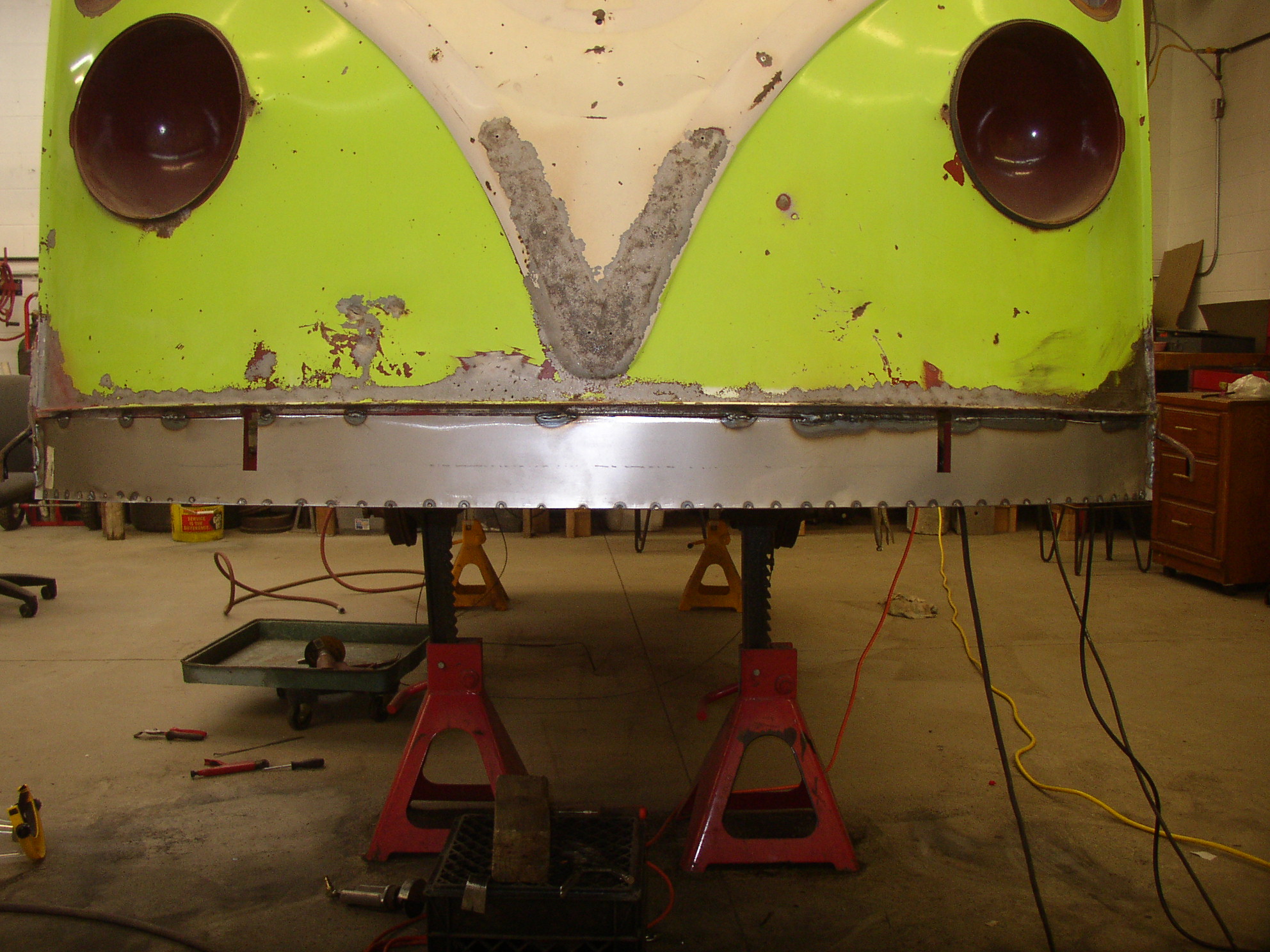

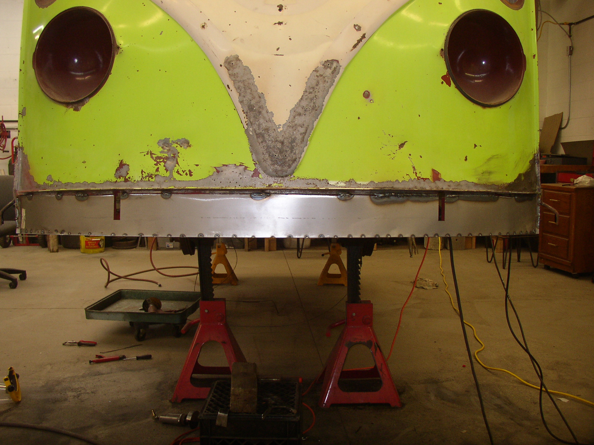

Fitting the outer valance. Once again, I spliced it and only used the lower half.
Here's where I stopped today- the outer valance is 80% done, just needs final welding.
My buddy's spot welder was the cat's ass for the lower edge- a real time saver.
I'm almost done with major welding, making me one fukking happy camper. I still will need to go around the bus and do final touch-ups with the mig, but all small detail shit.

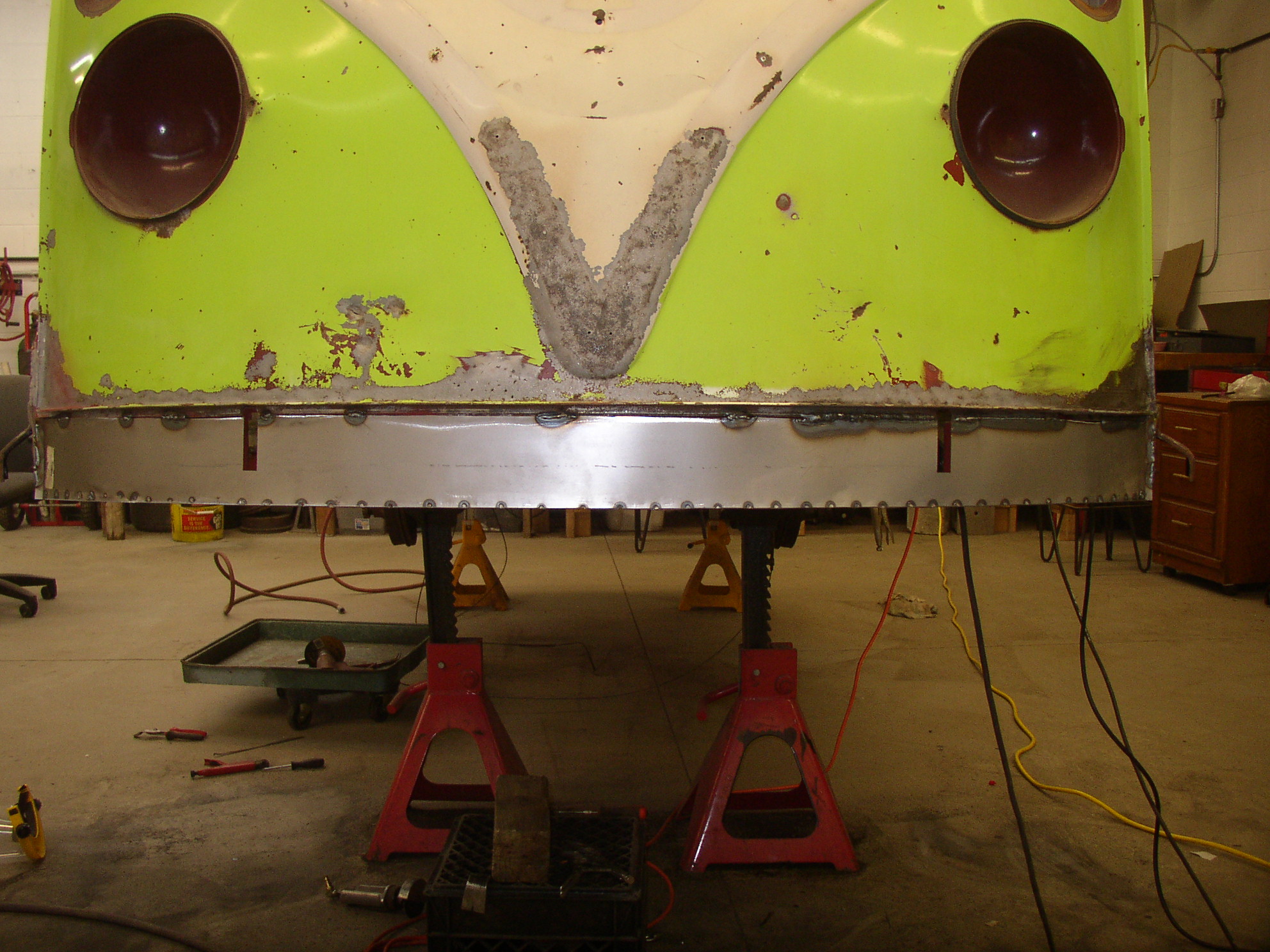

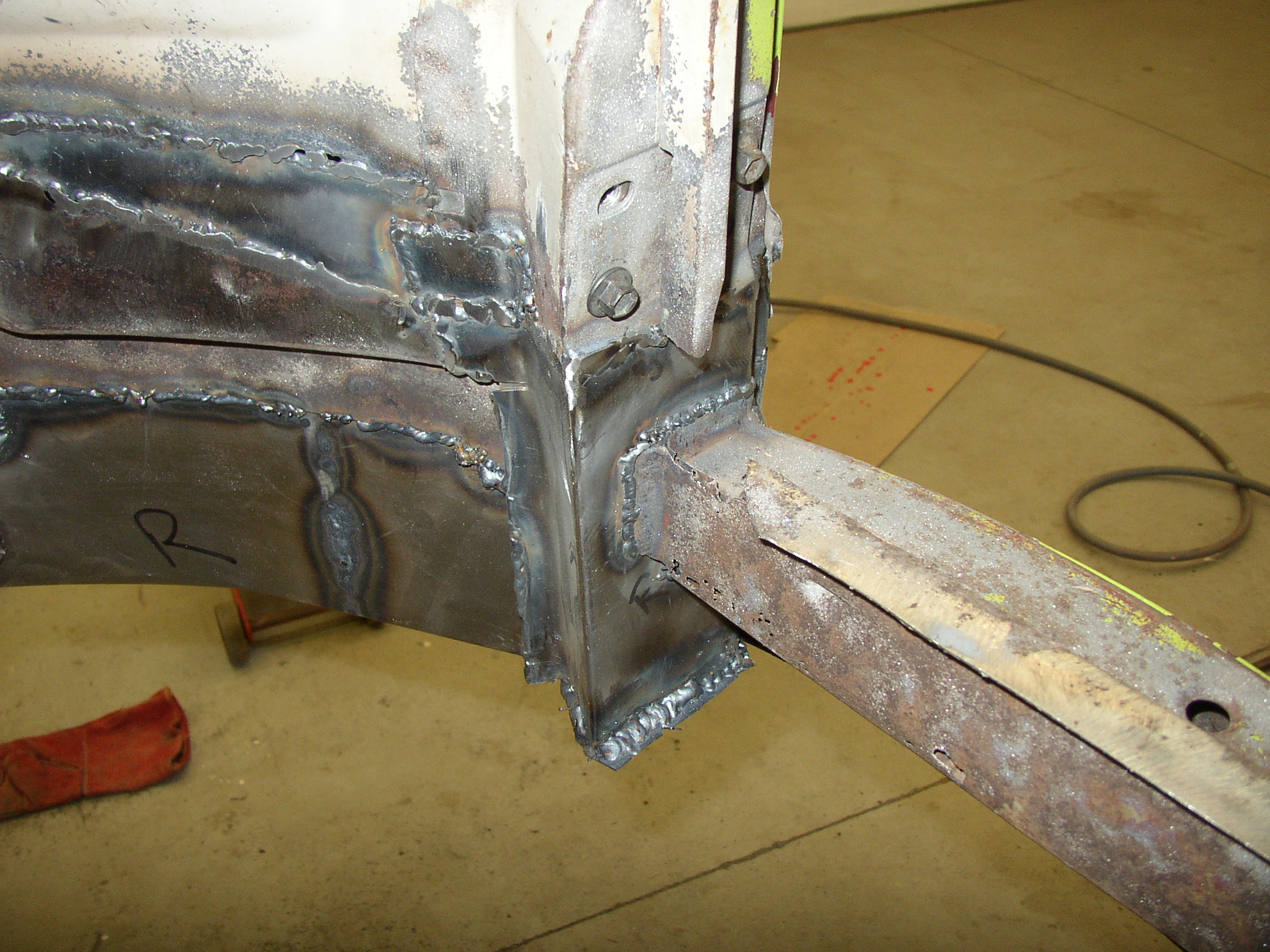

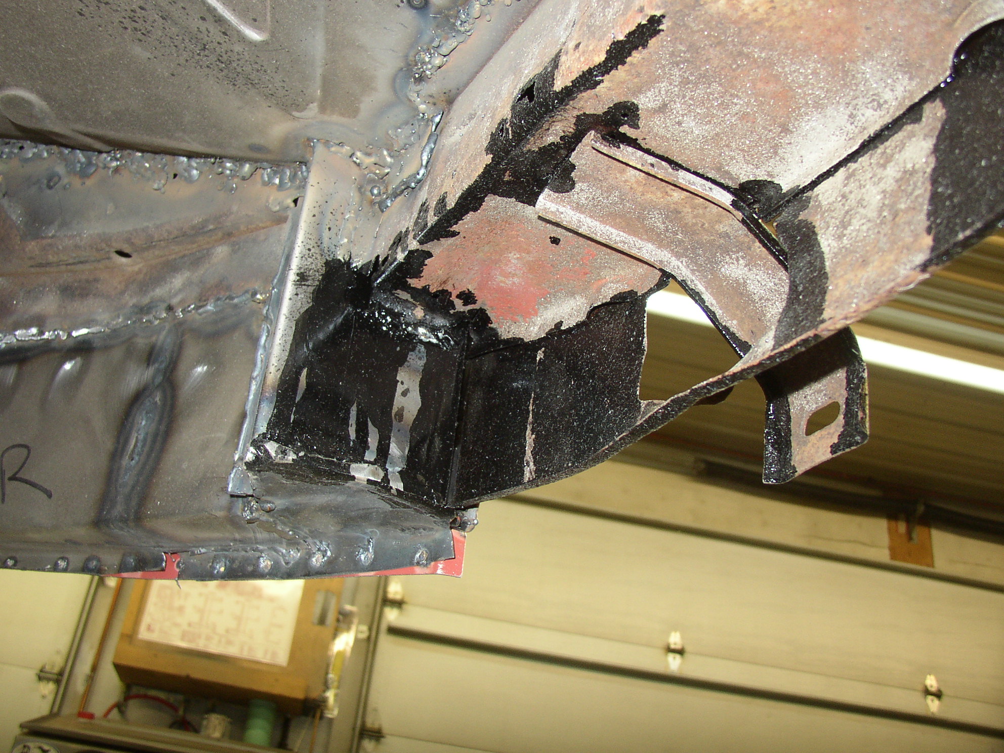

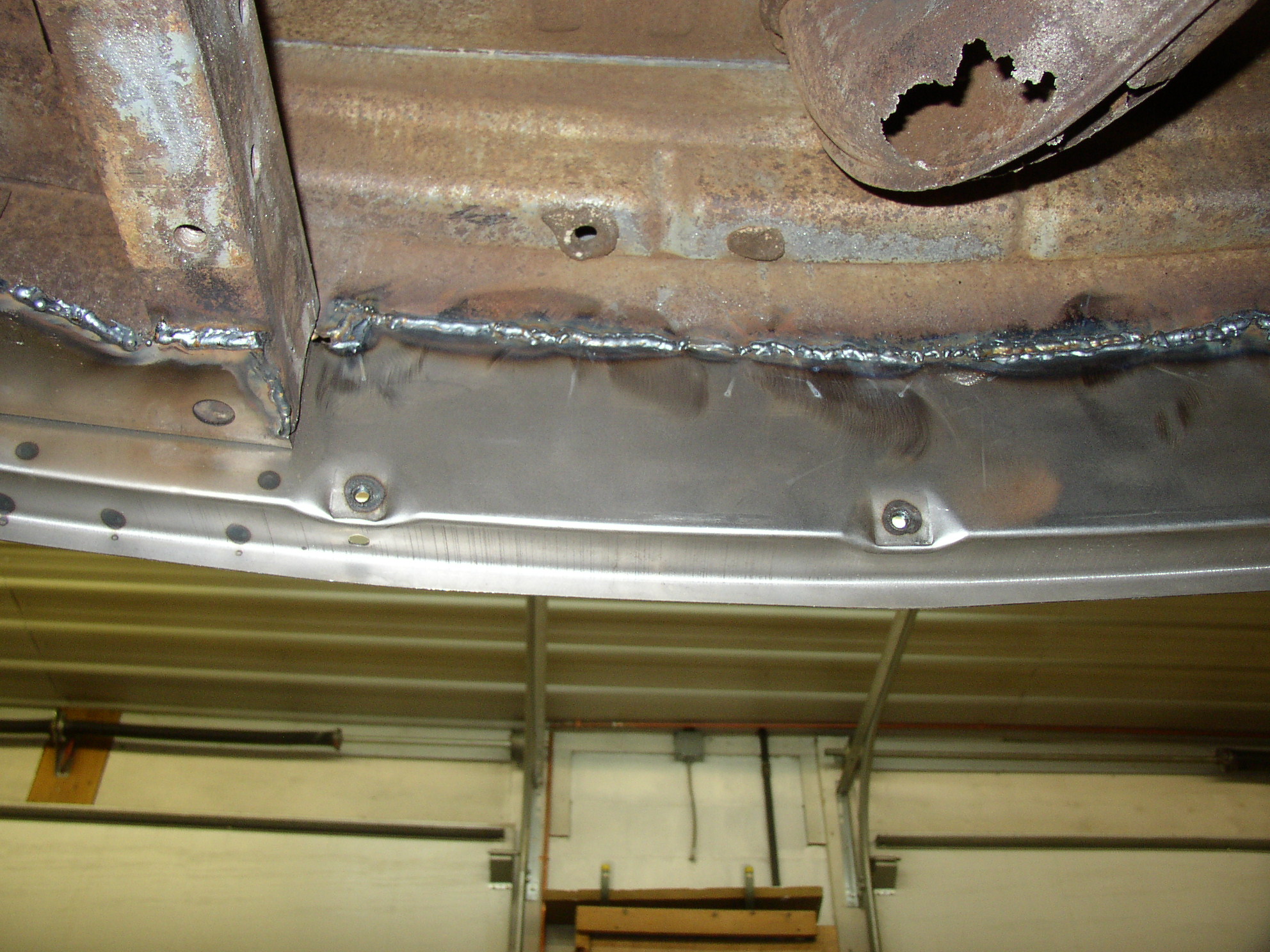

I finished welding and grinding the lower outer apron, it came out great.

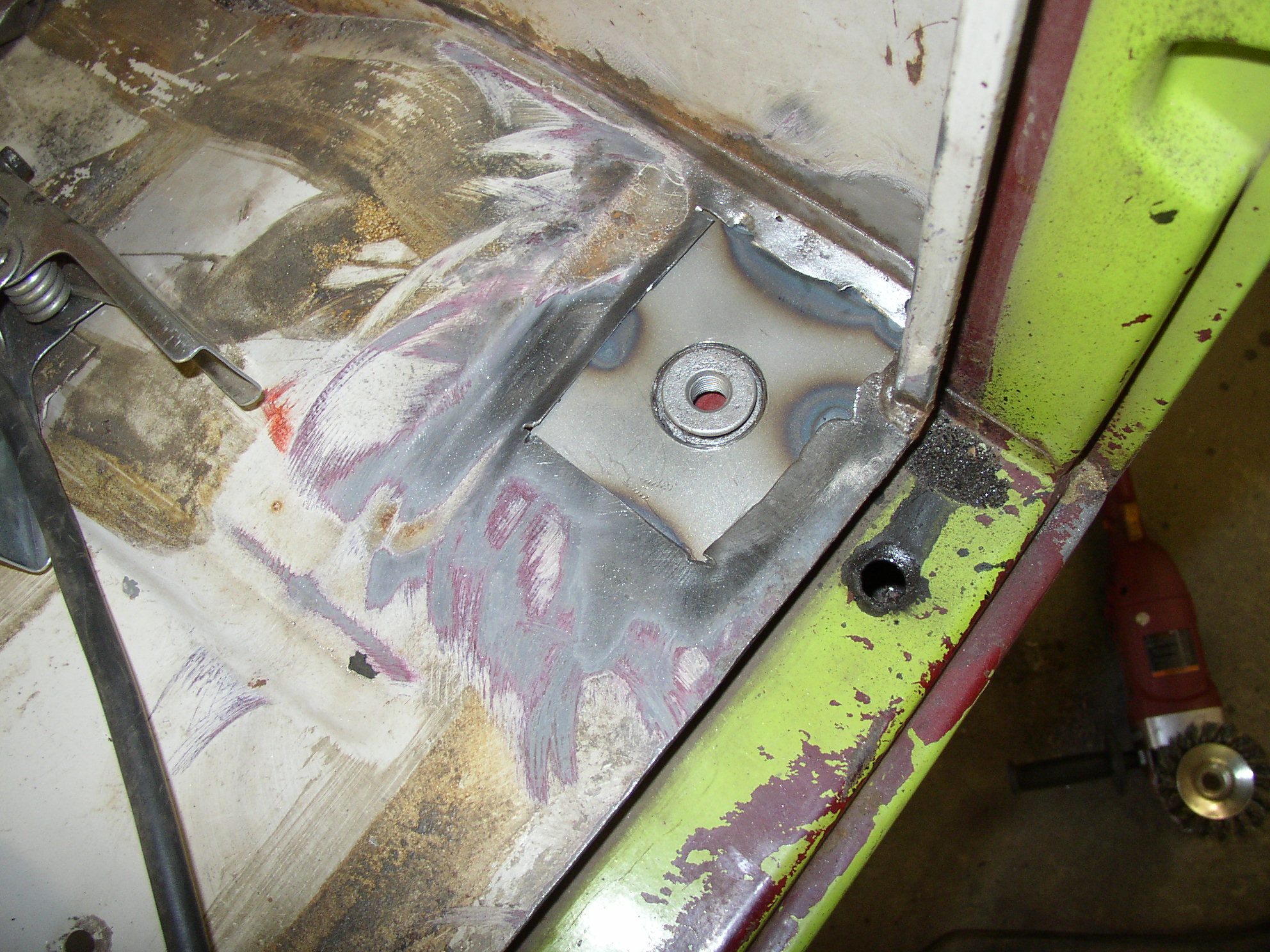

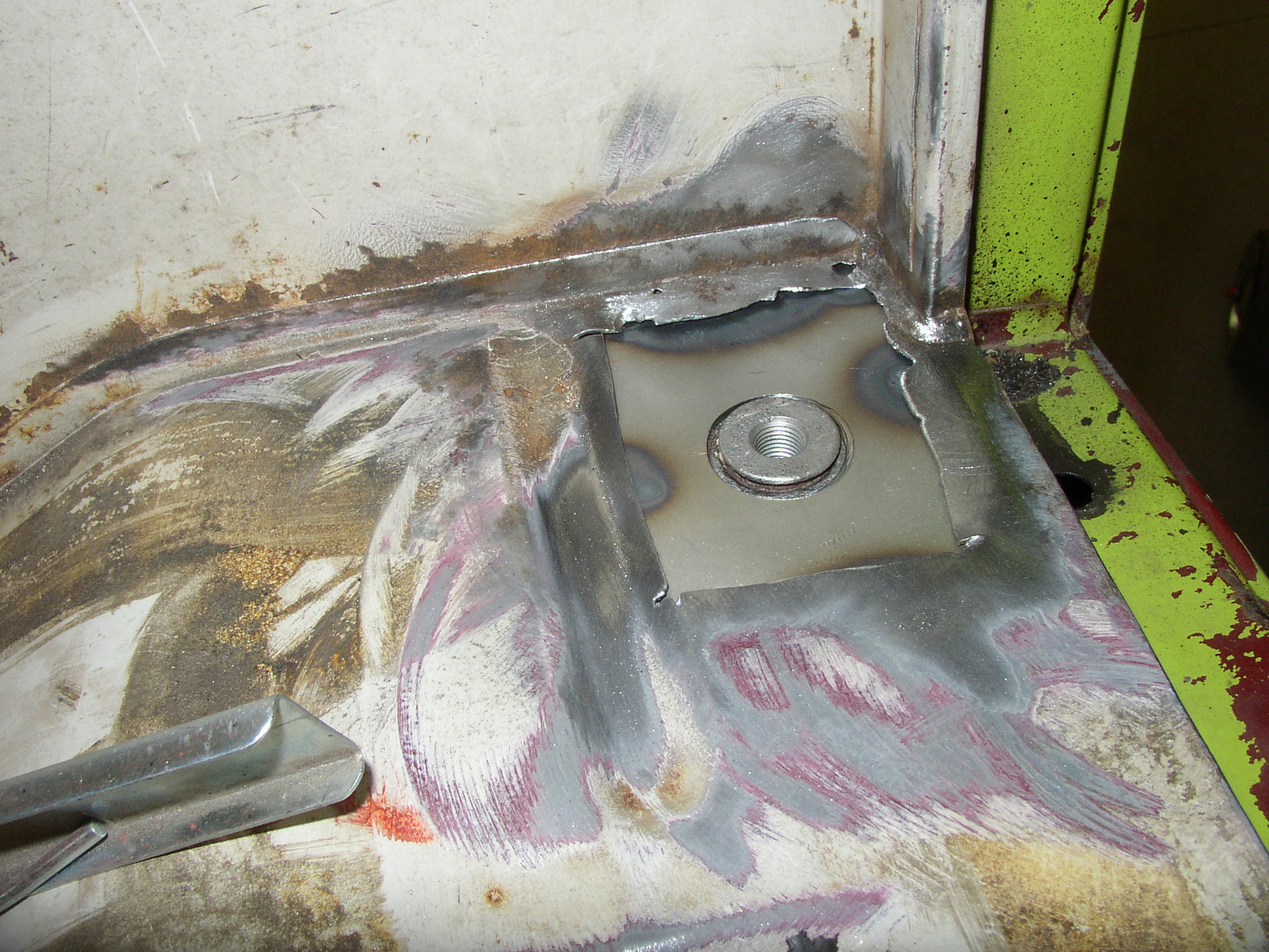

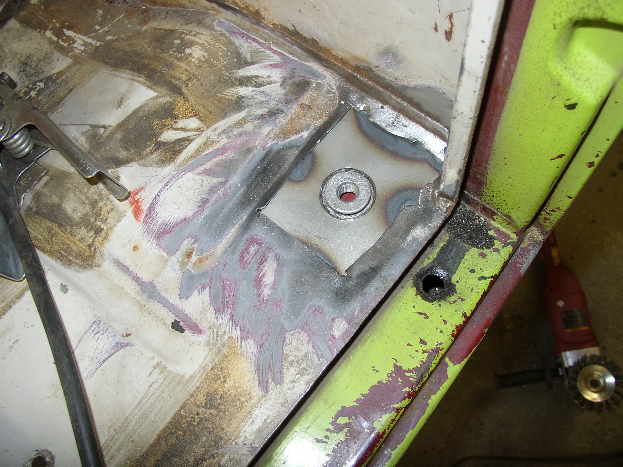

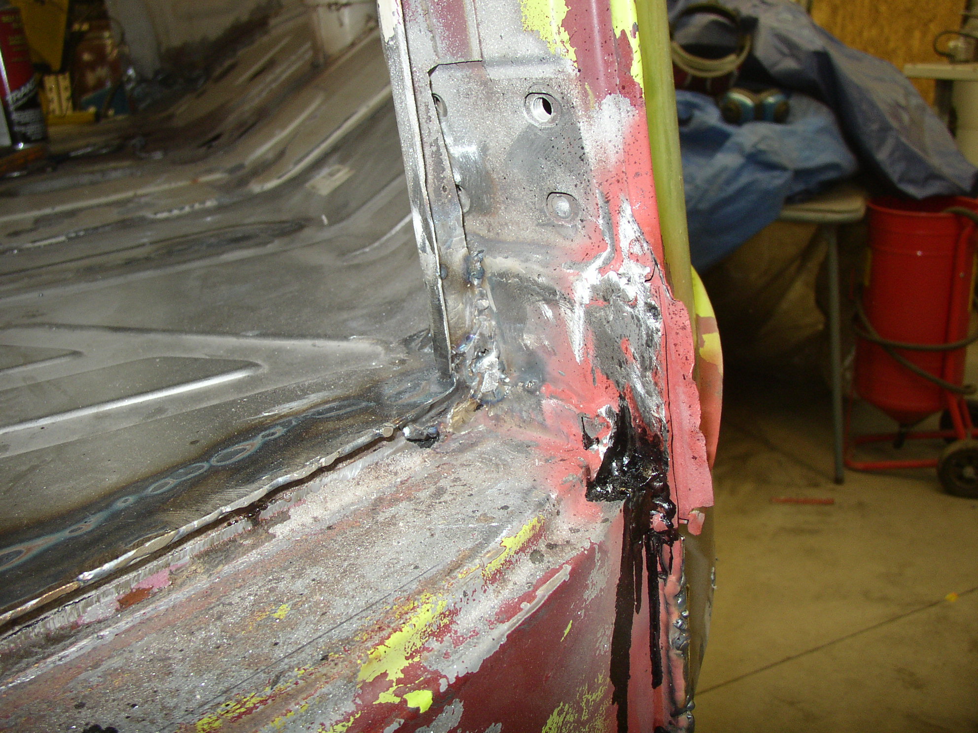

The left seat belt mount was a bit funky looking, but it wasn't until I cleaned it well did I find it was pretty rotted. Here's an old pic zoomed in, I didn't shoot any closeups prior to cutting it out.
Here it is done, it came out great.

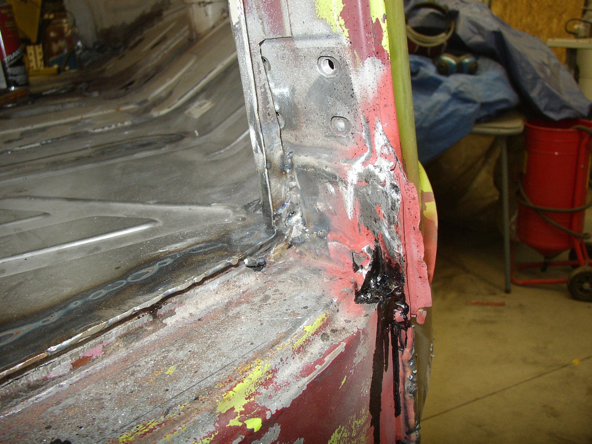

I used fiberglass jelly resin to seal up the welds around the wheelwells so water won't get in.

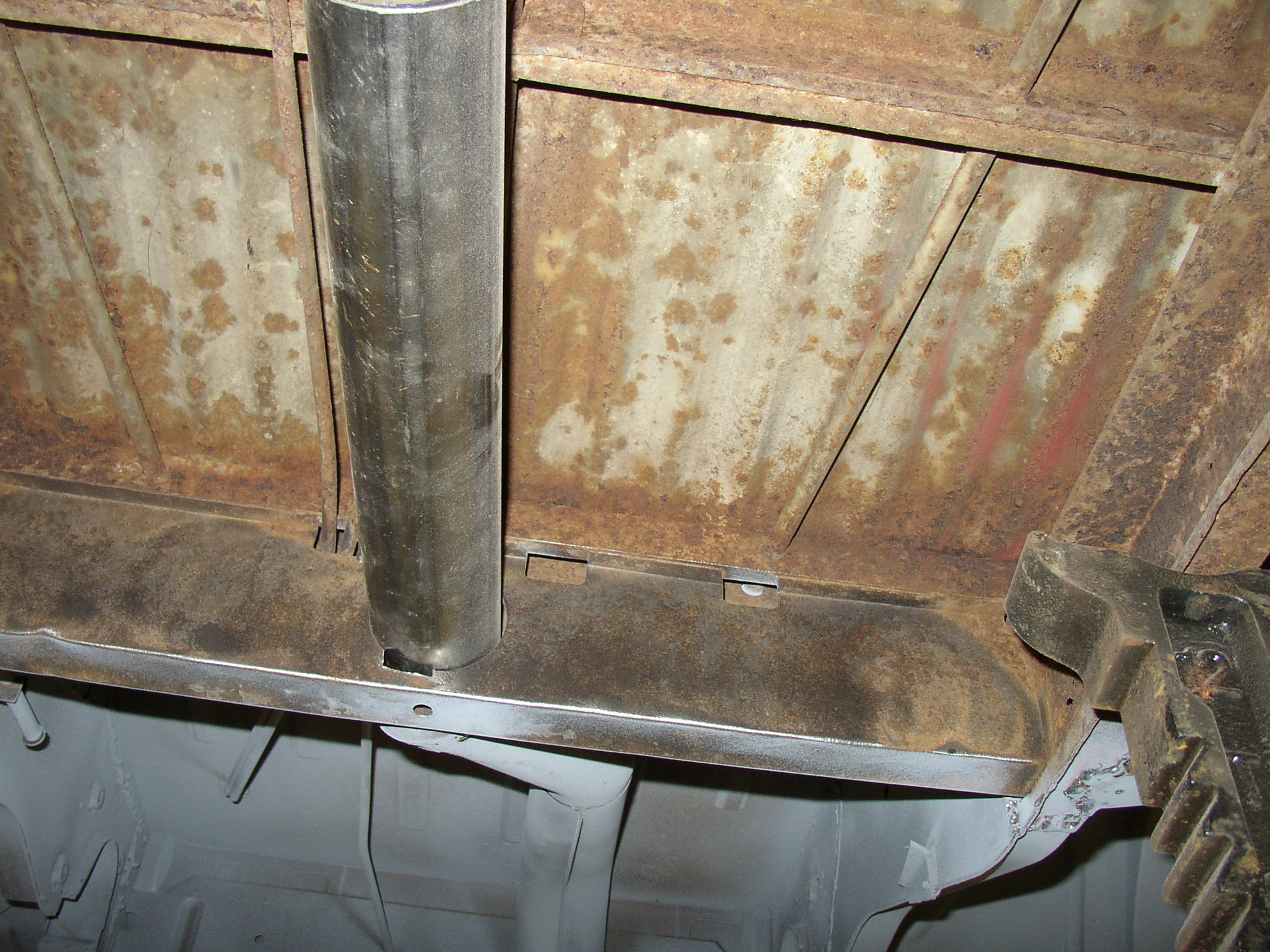

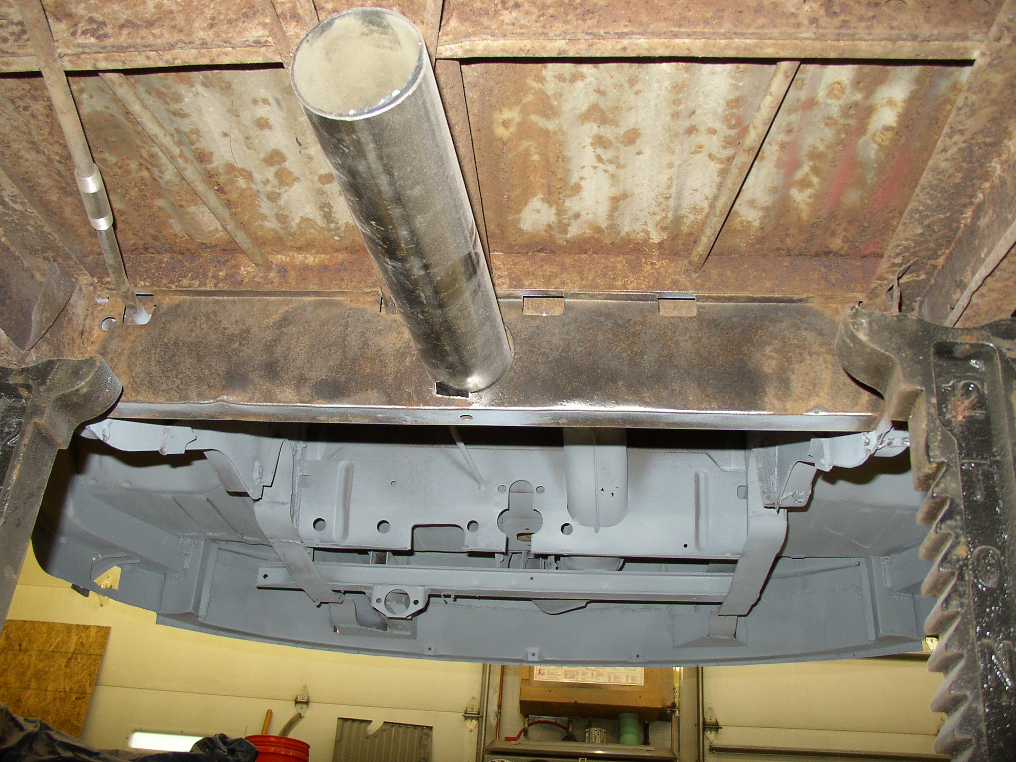

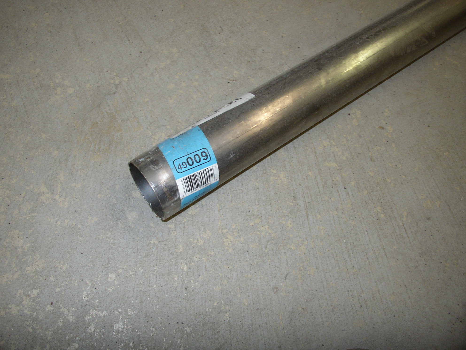

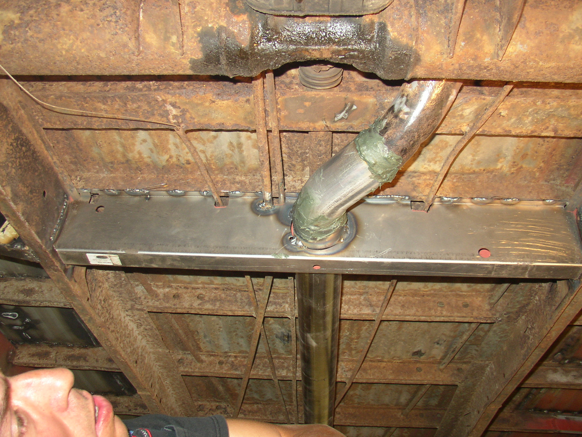

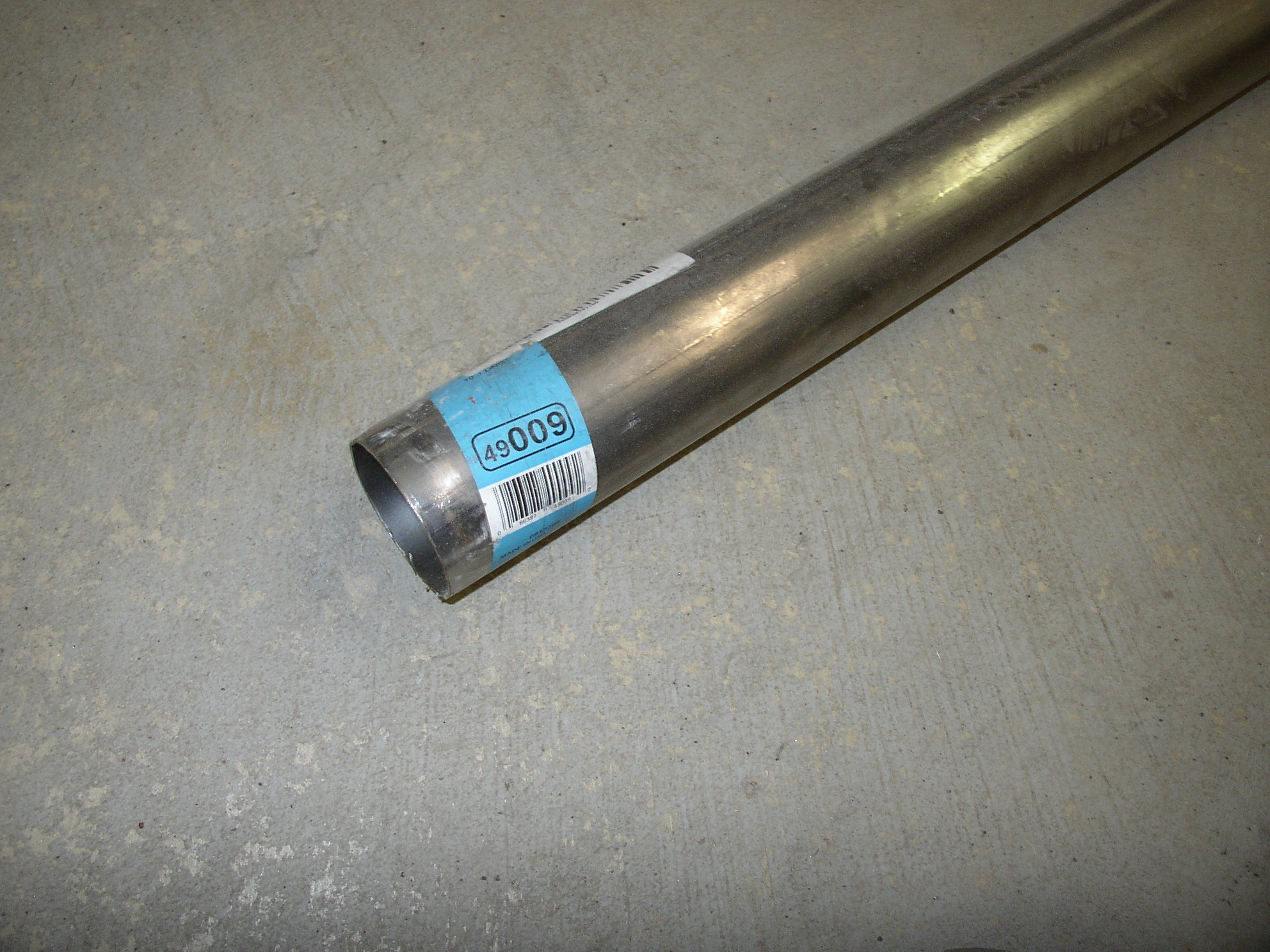

2 3/4" exhaust pipe fits perfect for replacing the rotted long heat tube, it's not easy to buy but Napa was able to get a 10' piece for $30.
Here is a small piece test fitted through the front crossmember and into the bent heater tube.

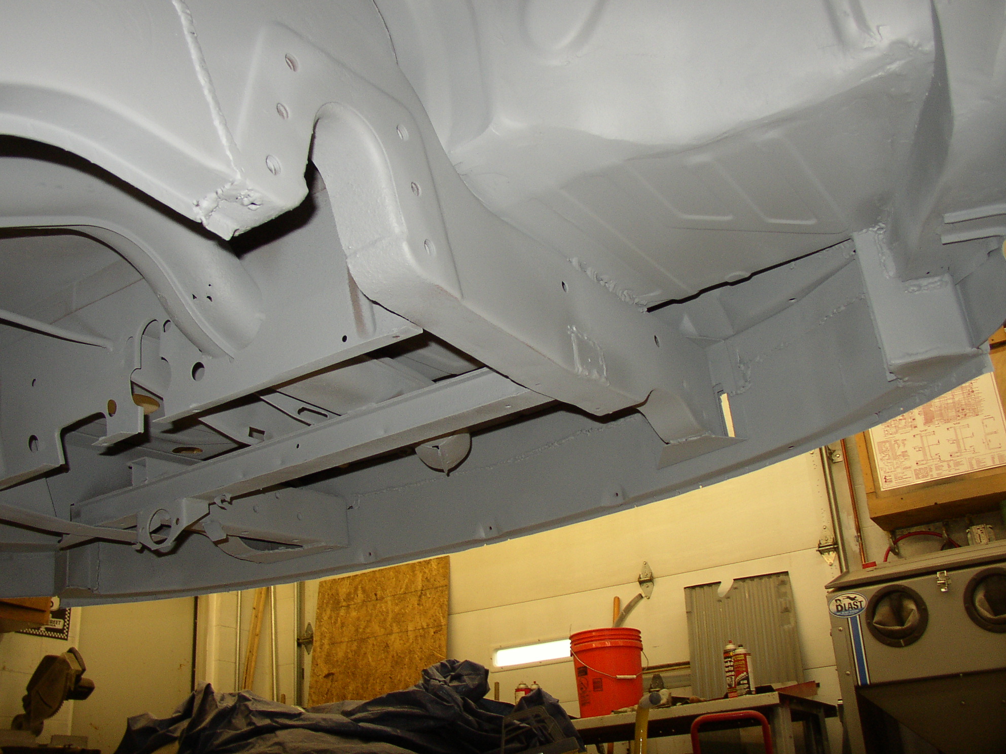

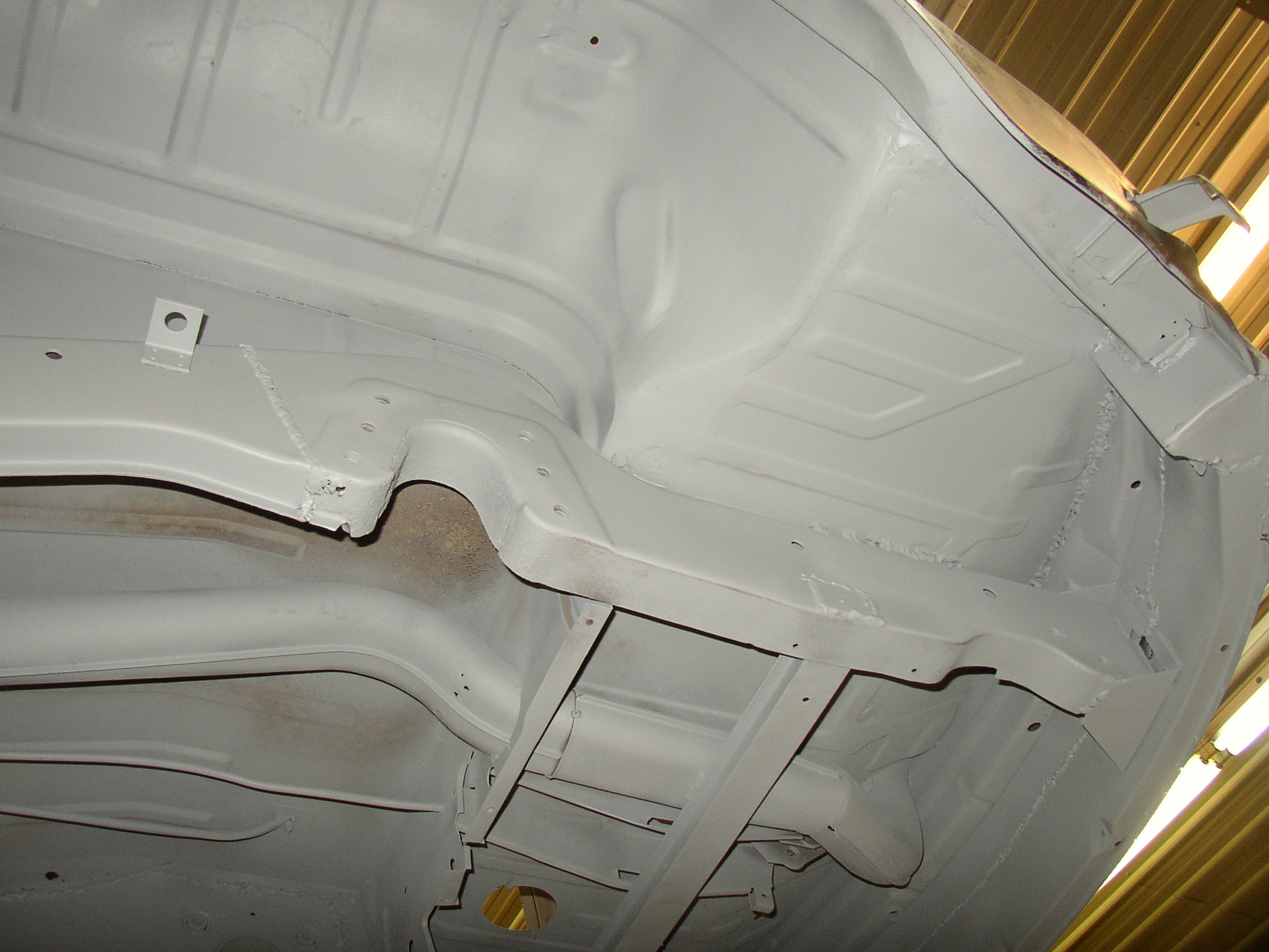

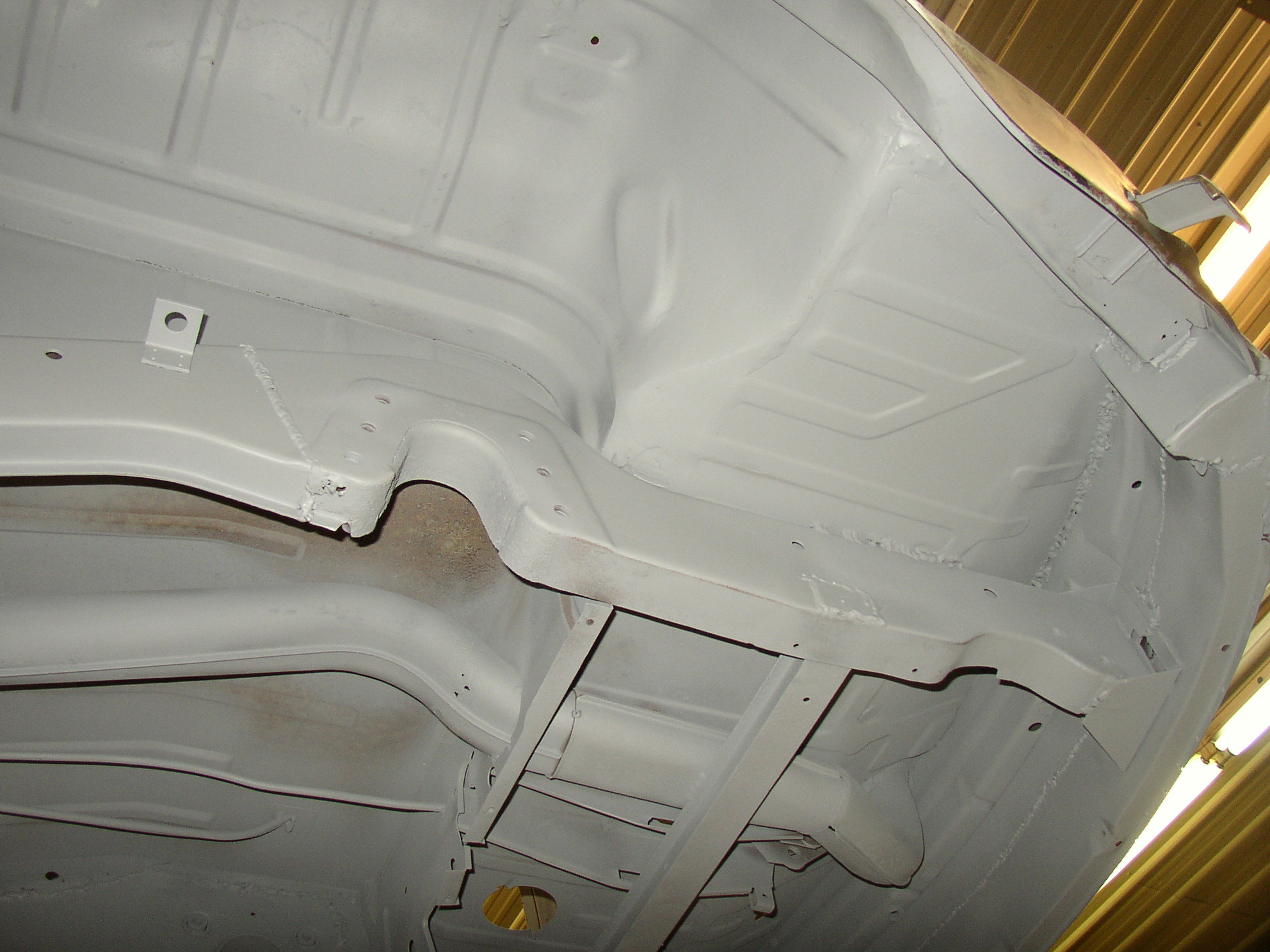

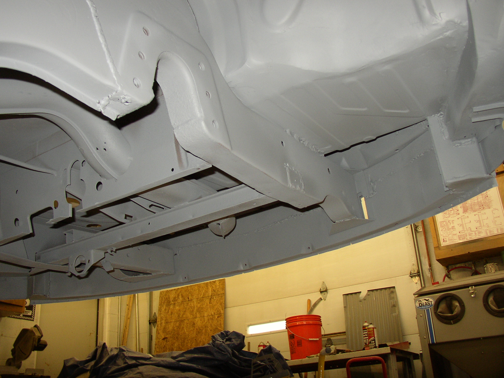

After sealing up the floors and bulkheads with FG, I mixed up some two part primer and shot the bottom. I'll continue working underneath doing a quick sandblast of the entire bottom and end up shooting gray acrylic paint on the whole underneath. I figure this is the best time, as once the outer body is done I sure won't want to be painting the bottom of the bus.
You might remember this front heater tube had a big rot hole in it, so I used glass mat and jelly to seal that up.

Replace the rear crossmember (ordered from ECC Tom), installing the heater tube at the same time so it won't have to be spliced. (est 4-6 hours)

This thread is awesome! Great work Bruce! I love the 360 degree sprayer "wand". Also, that's a great tip on the NAPA 2 and 3/4 inch exhaust pipe for replacement heater tube. Great job on the complicated welds. And the fiberglass seal is also a great tip.
