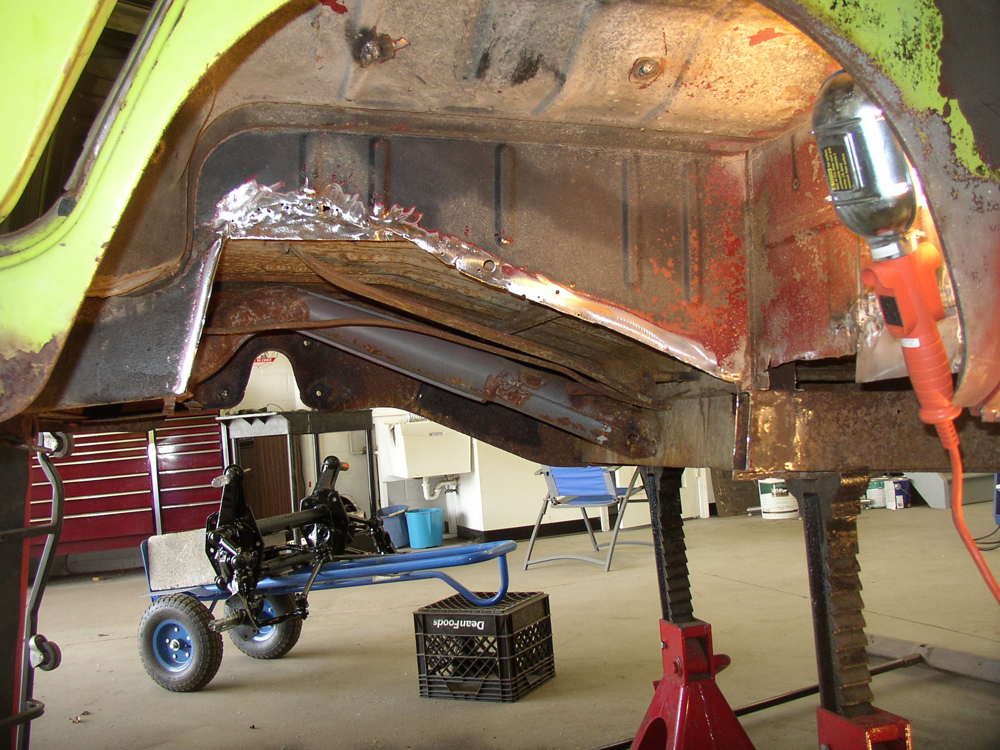

Both front frame rails show a bit of rot right behind the axle beam, but only after you poke and prod.

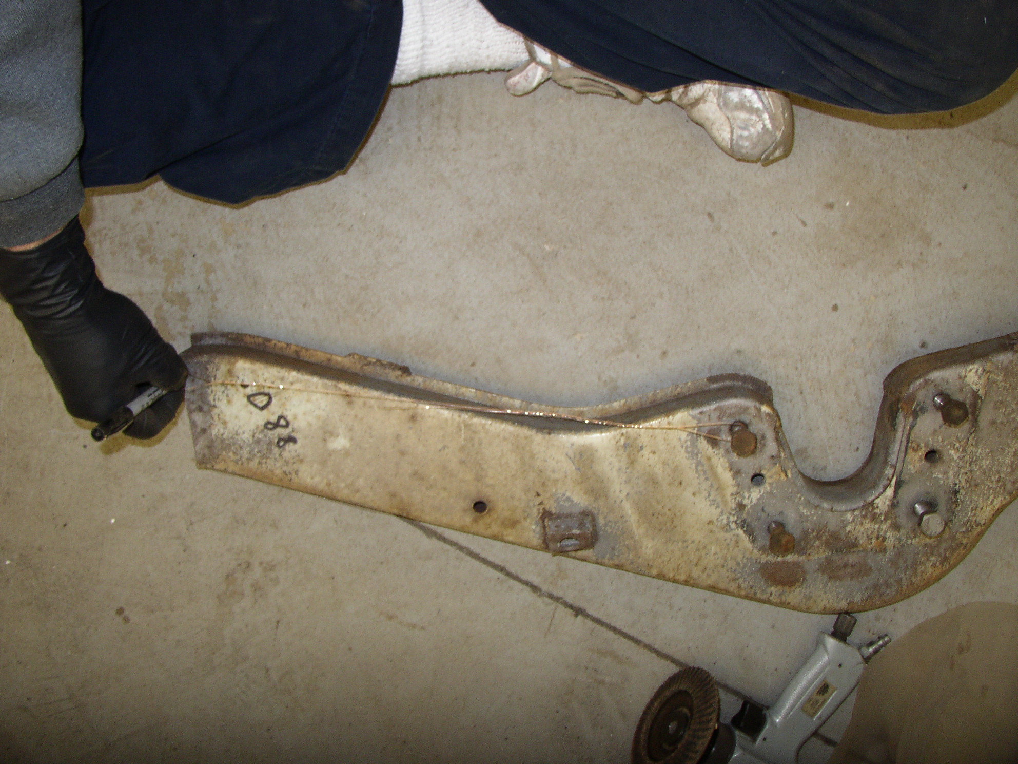

I ordered some nice rust free rails from Samba and they look great. The left rail was buckled a bit, I assumed from rot. I cut it open right at the buckle to find it was not rotted there! I can only guess a PO caught the beam on something in a previous life and the impact caused the buckle. It wasn't terrible, maybe 1/4-5/16" at most, just enough to see. Miking the rails showed only about a .005" loss due to rot at most of the rail. The .088" is what the "new" rail miked on the outer flange, the inner was

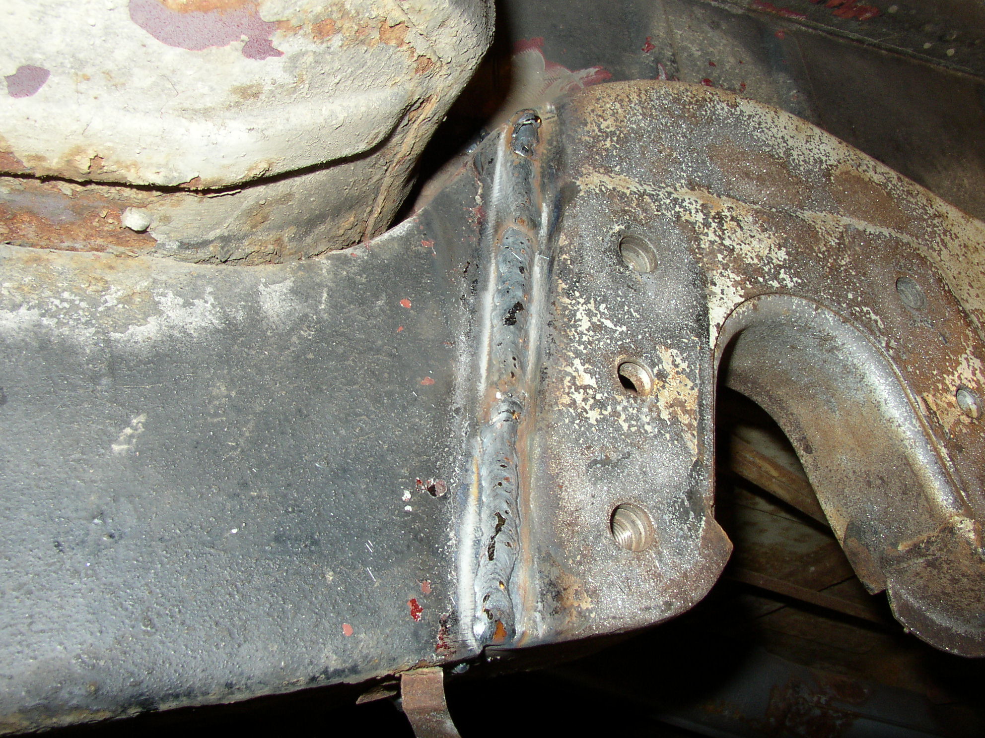

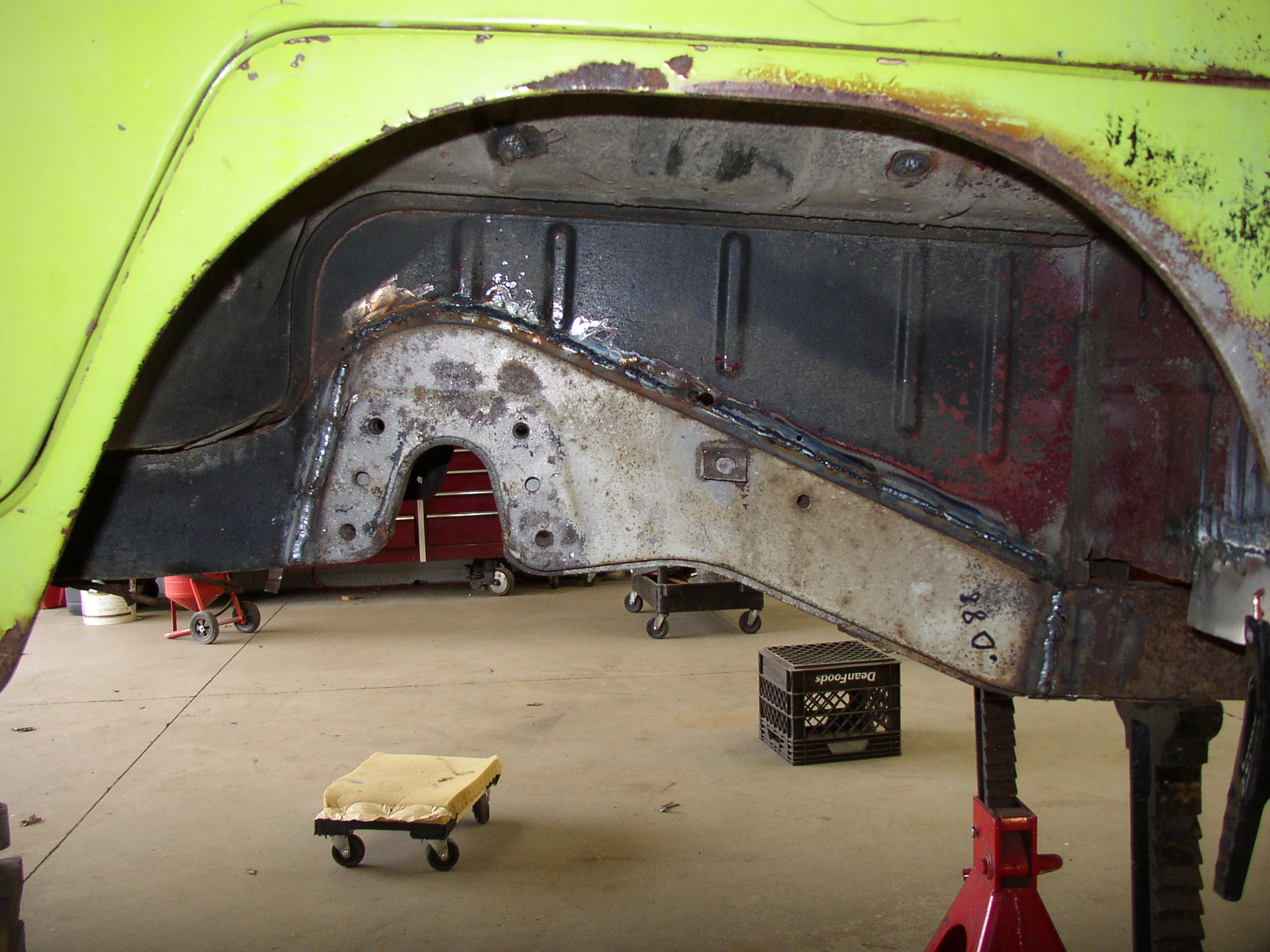

Here it is, fitted, installed, welded. I welded up a jig that double checked my spacing just like sticking the beam back in, becuase that bastard is too heavy to be messing with. I forgot to take a pic of the jig. :( I did measure the flanges, and they are just about exactly the 746mm it shows in the Bentley book. (Hooray! I got my Bentley! (used off of Samba) A bookworm like me loves to read the f'ing service manual for fun. And it gives great info I never knew, like the distance between nearly every point on the bus for the crash guys to align panels!)
My welds are getting better, especially on thicker metal.

Next: The right rail "looks good" at a glance, but it's tissue paper. Gonna cut and splice it too, but probably behind the axle bolt flange so it should go easier. The left rail took about 5-6 hours to replace, which I thought was pretty good.

Is that a broken tap in the lower rear axle bolt hole :?:
wwebner wrote:Is that a broken tap in the lower rear axle bolt hole :?:
Good eye! Yes it is, and I already blew it out with a torch without hurting the threads. It broke off when I was chasing them and got a little frisky. ;) I like chasing threads. It's one of those little quirky things that gives me a warm fuzzy feeling. :mrgreen:
