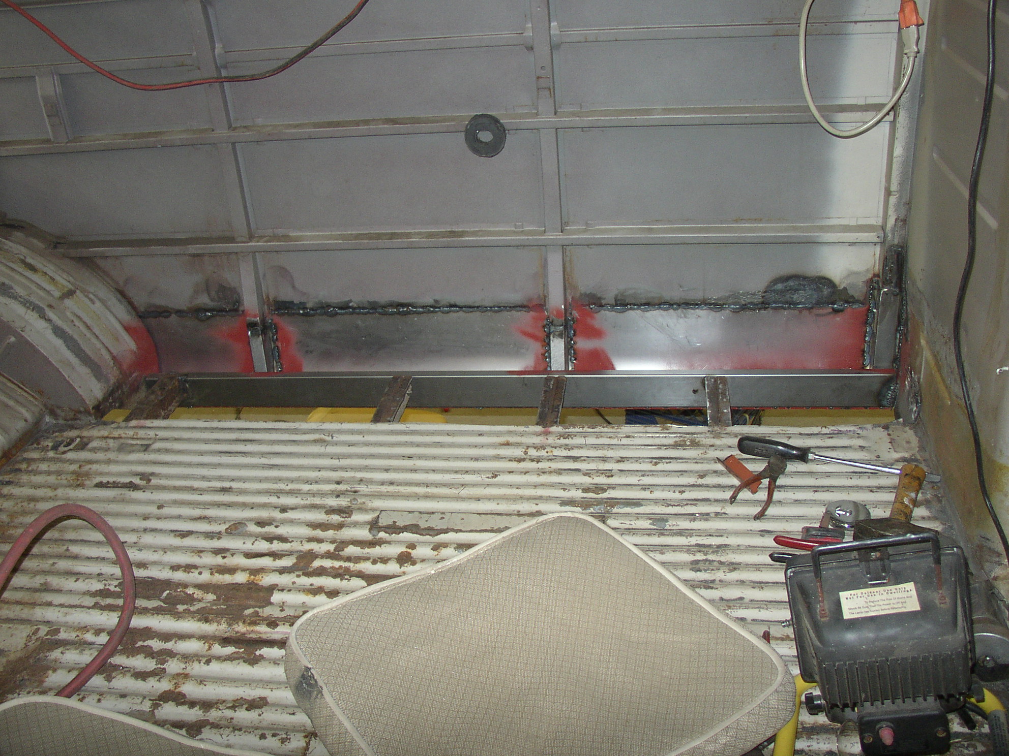

Nice job on the "butt" weld's Bruce. Like I said earlier, I find those to be very difficult unless you get the gas and wire just right. Looks like you were able to avoid that vertical outer seam. That's a relief. Battery tray looks great. Can't wait for the long left rocker pictures. That's where I got impatient and warped mine.

I cut all of the bad shit oside and made a "rough cut" for the rocker.
Tomorrow- fix the front bulkhead.

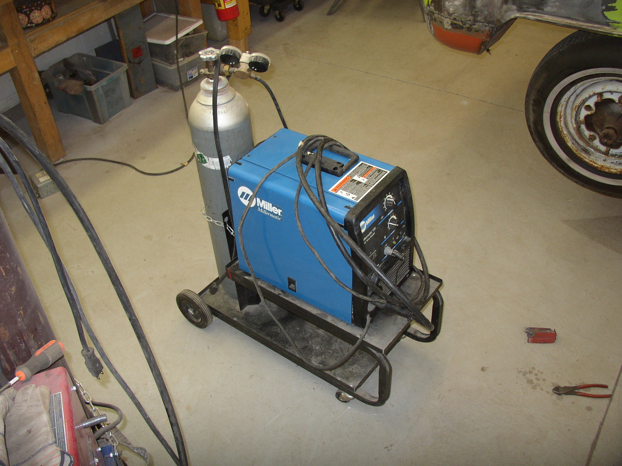

I got lucky and scored a great deal on this Millermatic 135 off of CL, I saw it listed just minutes after the guy put it up. First come, first serve, they guy said he could have sold it a dozen times, it was $400 with the tank and cart and has low hours. It welds MUCH better, I am happy![img]

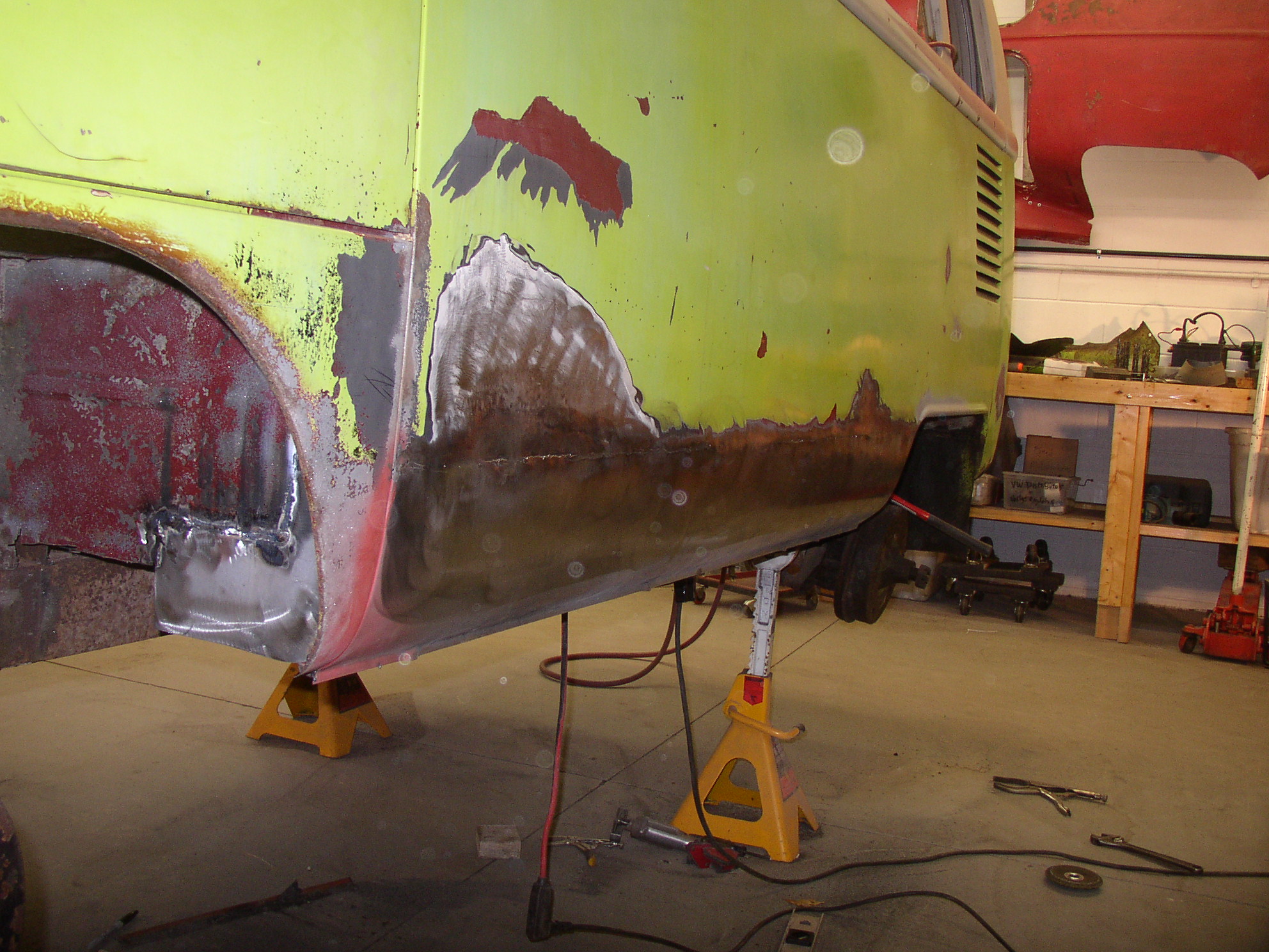

I thought about butt vs lap and decided to go with butt. Here is the final fitting of the panel and ready to tack. Gaps are too small for a panel clamp to fit in. The fit of the panels from ECC is excellent, much better than that clusterfvck on the right side.

Doing the cut I found yet another dent filled with 5/8-3/4" of mud just behind the driver's door. Did this PO drive using the braille system? Jesus, there's little bumps and bruises everywhere. I straightened it out and shrank it back flat using the torch and wet rag method.
Here's the panel tacked in place, now play connect-the-dots.

Nice work Bruce. Was your old welder an LE? I have one of those 110 Clarke w/gas. I think they're made in Italy. Not bad, but not a Miller. My next welder is a Miller or an LE.
I see you were able to save the lower metal just in front of the seam under the door. Looks like you cut your metal even with the seam. I didn't have that luxury as mine was all crap. I initially "mudded" over my seam, but thankfully my painter fixed it for me.
Looks like you have a nice fit with the area where the seam meets the rear wheel well. I got lucky with mine by overlapping the wheel well flange on the new metal that covered that connection point. I didn't know what I as doing. I was just lucky! Your's looks a lot better than mine!

Yes, the other welder is a Lincoln Handy Mig, which is their entry level model sold at Home Depot and not at the "real" welding suppliers. The guys at AGA laughed when I asked for a liner and other things as this model doesn't get much respect, I was hoping to support a Cleveland based business to find the sucker is made in Poland. There's a reason a new Miller is almost 3 times the cost of a Handy Mig.

Since i don't have a 220 line, I'd be happy with one of these http://www.millerwelds.com/products/mig ... del=M00234
I wonder how accurate the auto setting is on these models? If it's even close, it would make welding panels a cinch.
