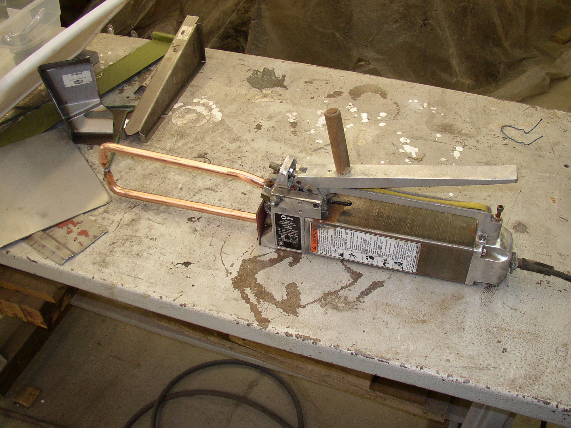

A friend loaned me a NICE Miller 220v spot welder:
This made the lower pinch welds a piece of cake:
