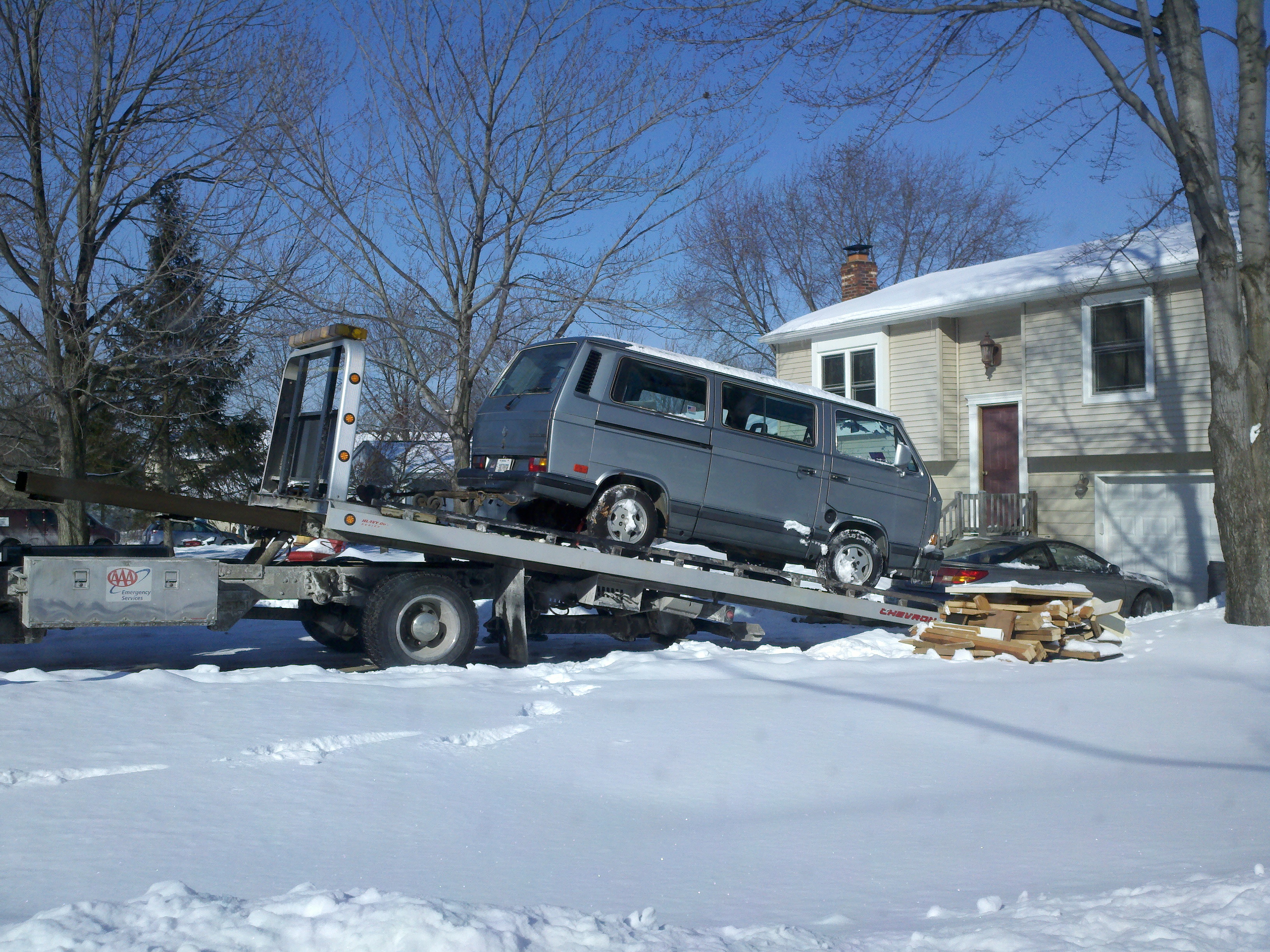

We got the van back. Nick drove it a couple days. Hose ruptured, he lost coolant. Heads got warpted, things got melted. That's that. It is getting fixed again now. If anyone wants to take this thing off my hands let me know. Im just fed up rite now. Vanagons are very expensive to fix and im sticking with air cooled. Just blowing off a little steam and you will probably see him driving it around to some of the events this summer unless another one of the THOUSAND cooling componets goes bad and I end up scraping that PILE! Ok now that that's off my chest, see you guys thursday. Its ST. PATTYS day and if anyone needs a ride to or from Basil's I will be happy to give you a lift. Peace.
