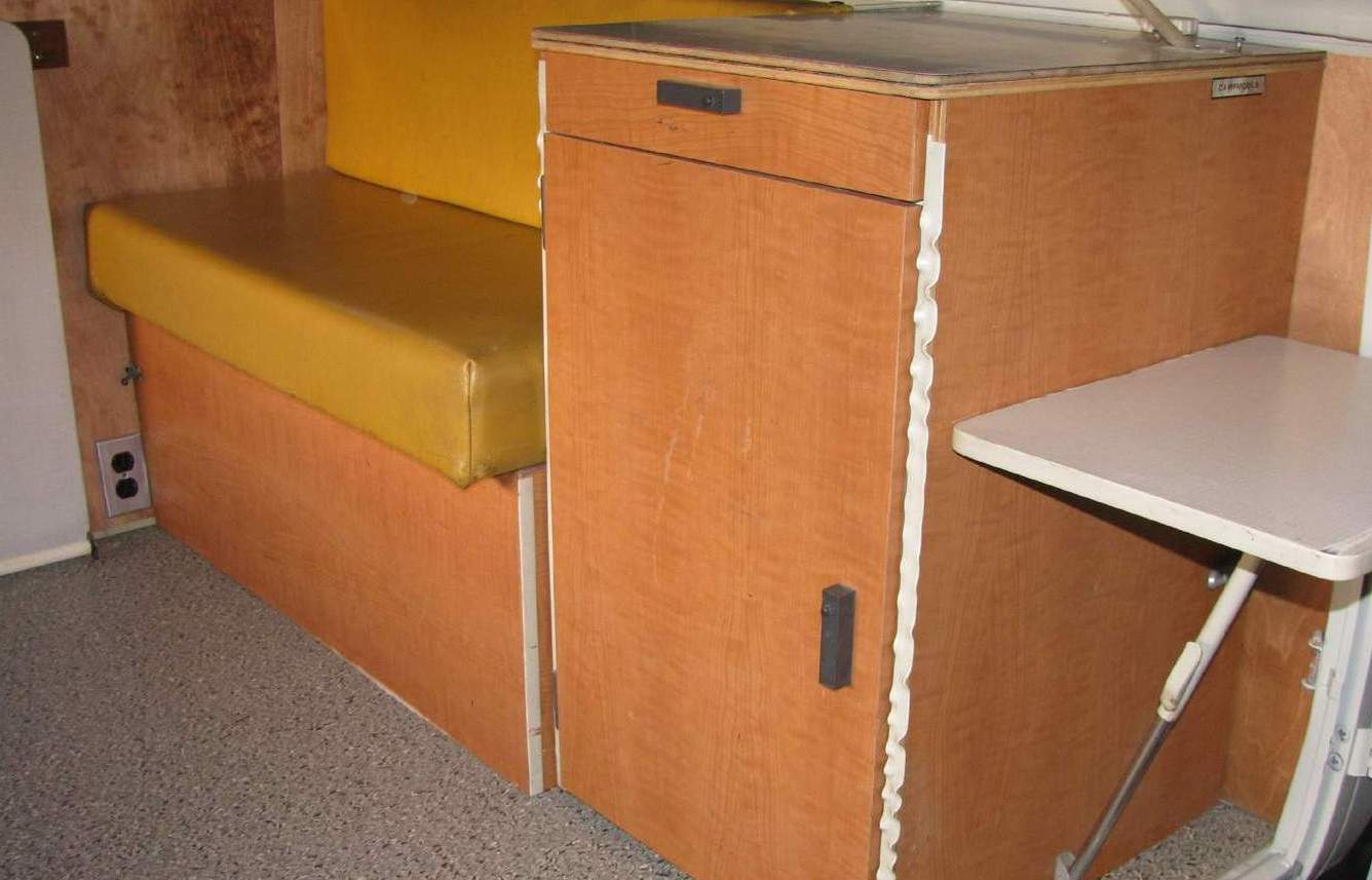

Got my new clutch, pressure plate, & throw out bearing so the engine is going back in this week with the new doghouse cooling set up. Been working on getting the flooring done and paneling up so I can start to put the seats and closet in next.
Also said goodbye to a 63 Beetle that we've owned for 7 years. Felt like I sold one of my kids. I have an amazing tolerant wife when it comes to VWs but I realized I couldn't drive 3 of them at the same time.
Craig

Thanks Ken.... here's a couple more.

Re: 65 Westy
Great looking work! Nice attention to detail
Re: 65 Westy
Nice what exactly did you use for the flooring?
65Westy
Posts: 162
Re: 65 Westy
Post by 65Westy »
Its called Marmoleum by Forbo. I found out about it from a couple of threads on Westy flooring on the Samba.
